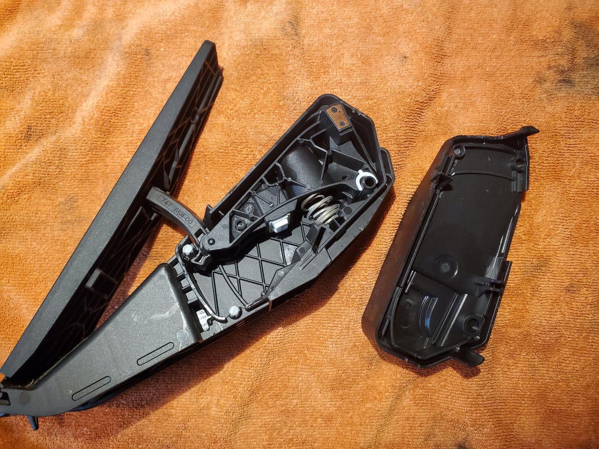

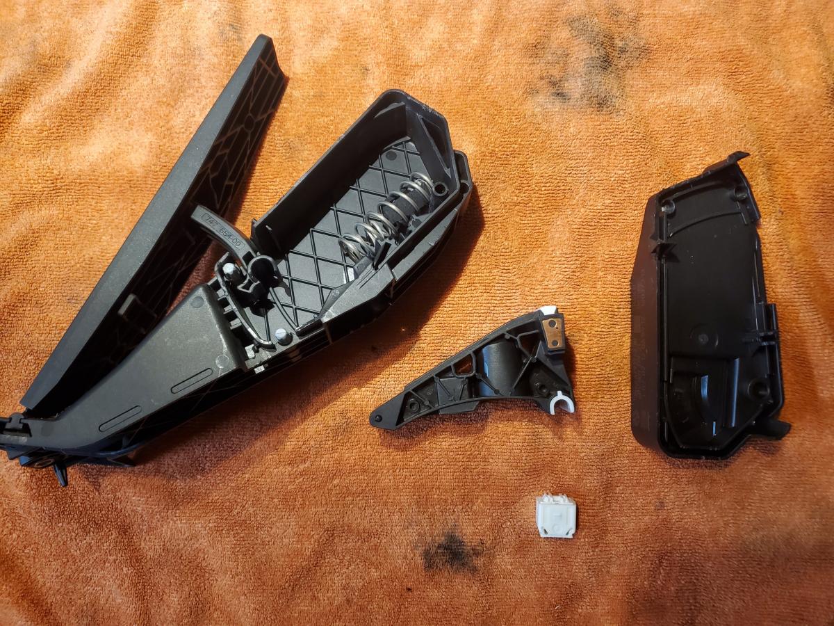

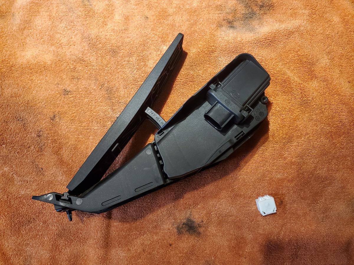

          Sorta off topic, but just did this in an auto E82 (really don't like the kickdown even if it's an auto).
          Pedal was more annoying to take apart because it's held together by clips, but it was significantly easier to remove from the car. Held in by a bolt and then it comes out:
