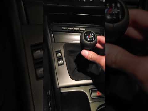

    Shifts feel significantly better, but there's still a bit of side to side slop in the shifter. This slop is enough to where I sometimes have trouble finding third when shifting quickly from second.
    Here's a video of the slop:
    Is this just an inherent characteristic of the 420g? Or is it possibly due to those two detent spring I didn't change?
    looks totally fine to me.
      Normal for this gearbox
        Your side to side play looks similar to mine, and my shifter linkage is completely new from my 6MT swap 2 years ago. I agree that it's a surprising amount of play.
          I rebuilt mine recently including UUC Evo and new selector rod joint and I have about twice the side-to-side freeplay that you do. For me the slop is all in the selector rod joint pin. If I ever have the trans off I will machine the holes slightly larger and have a tight fitting pin.
            Like all the above, seems normal. Mine is the same.

              I think youve gotten as close to zero slop as possible with the normal oem setup. For something tighter youre probably looking at performance racing grade
                Thanks for the responses guys. I was kinda hoping I could throw more parts at it to get it even tighter but I guess I'm going to have to learn to live with it like it is now.

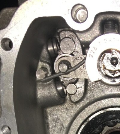

                After looking at a couple images of the bellhousing, I'm surprised as to how much space there is between the bearing and locking pins.
                Since people who did a 6MT swap seem to still have this behavior, I doubt that it's due to a tired torsion spring.
                ​​​​​​​I'm thinking that possibly on oversized bearing will help reduce slop, although no clue if it would still interface correctly with the locking pins. Maybe if I'm really bored one day I'll find a bellhousing and mess around with it.
