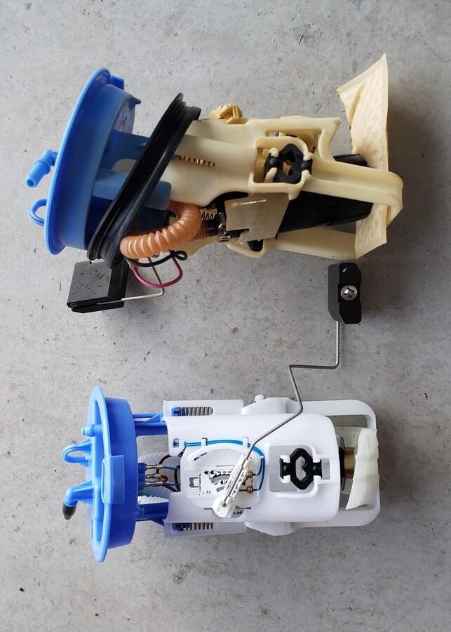

    i had this exact issue. mine was fuel pump. replaced it with OE and started right up. After going through the process and doing research, seems like its a somewhat common issue.
    mine was 18 years old. Night and day difference.

                        Another option available is to use the radium engineering kit to swap the pump itself while retaining the original housing. I swapped an AEM 340LPH unit into mine a couple weeks ago and have been happy with it thus far, quieter than the old unit that was likely failing, but time will tell as far as longevity. Got away with it for around $170 if I recall correctly, doing the swap added an hour or two to the procedure for me.
                          I recall reading awhile ago that a few folks had issues with the radium kit and the included electrical connectors arcing and melting (causing intermittent or total failure.) Do you know if this was ever addressed? I'm planning to replace my pump in one way or another soon and would rather do the radium kit if all the kinks were worked out...
                            They updated their instructions (and possibly the connectors?), but I just soldered and heat shrunk mine instead.
