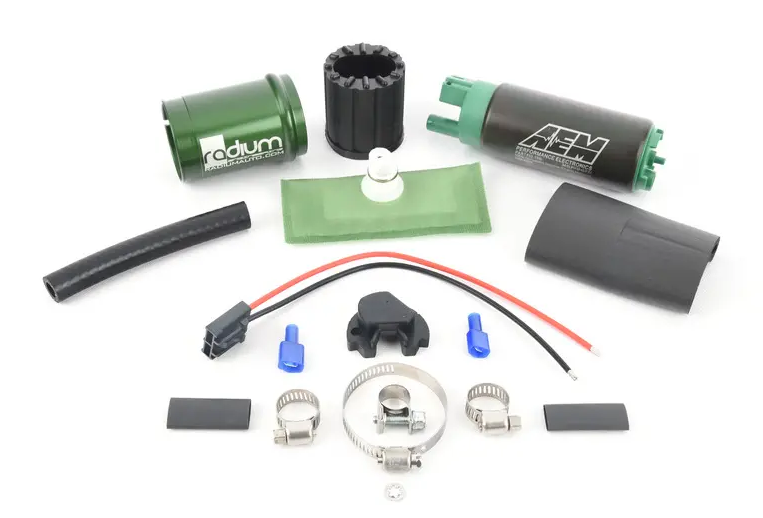

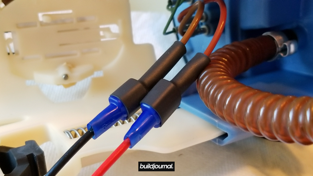

    I recall reading awhile ago that a few folks had issues with the radium kit and the included electrical connectors arcing and melting (causing intermittent or total failure.) Do you know if this was ever addressed? I'm planning to replace my pump in one way or another soon and would rather do the radium kit if all the kinks were worked out...
    Interesting, I haven't personally heard about these issues when I bought the kit, but then again we had already lost M3F at that time.
    I did notice when installing the new pump that the blue spade connector for the ground wire (the smaller of the two in the image below) did seem to be slightly looser when connected to the female end that runs from the original pump housing. The spade connector has an internal tab that you have to make sure mates to the other end, so after hooking the tab, squeezing the shit out of it with pliers, and applying the heat shrink I figured it would be solid enough. I could see someone messing up the electrical connections if they aren't careful, which might account for the failures. It's Step 17 in Radium's install instructions.
    Either way, probably best to reach out to them directly. Would be very interested to see what they come back with if they are aware of the issue since I'm running the kit myself.

        I think that spade connector is the one in question, except it's the hot lead (larger) one that ends up arcing and failing - here's the link of the article I initially saw the issue..looks like it was a follow-up article after putting the pump to use. I was pretty set on going with the setup until I saw it. Great write-up by Andrew @ Buildjournal:
        https://thebuildjournal.com/news/you...-you-stranded/
        [AW / Cinnamon / 6MT] /// [build journal]
          😮 that is not comforting, perhaps I need to go in and solder mine as well...
