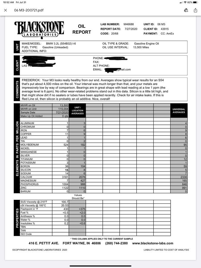

              Interesting, thanks for the suggestion. I requested a new test kit from Blackstone and will post back up results. I don’t have a pressure tester but maybe my local Autozone has one?
              BTW, I just had my oil tested (13,500 mi) and came back in great shape.

                wowow you're running near the "BMW recommended" oil change intervals? that's wild. curious: how much extra oil did you have to add over the course of those 13,500 miles?
                  I just picked it up recently and that’s what the previous owner did but I plan on doing 1/2 that interval. According to the previous owner, he didn’t have to add any. I ran the blackstone to see where the motor currently sits. According to those guys, the oil looks great.

                    Low lead levels do not necessarily correspond to the bearings being in good shape. It's possible that the lead coating is completely worn through. Copper is a bit high too.
                      A 2006 M3 with no prior bearing service @ 115k miles should have the bearings done. Regardless of UOA.
                        I was going to do them anyway but I had not thought of that. Scary!
