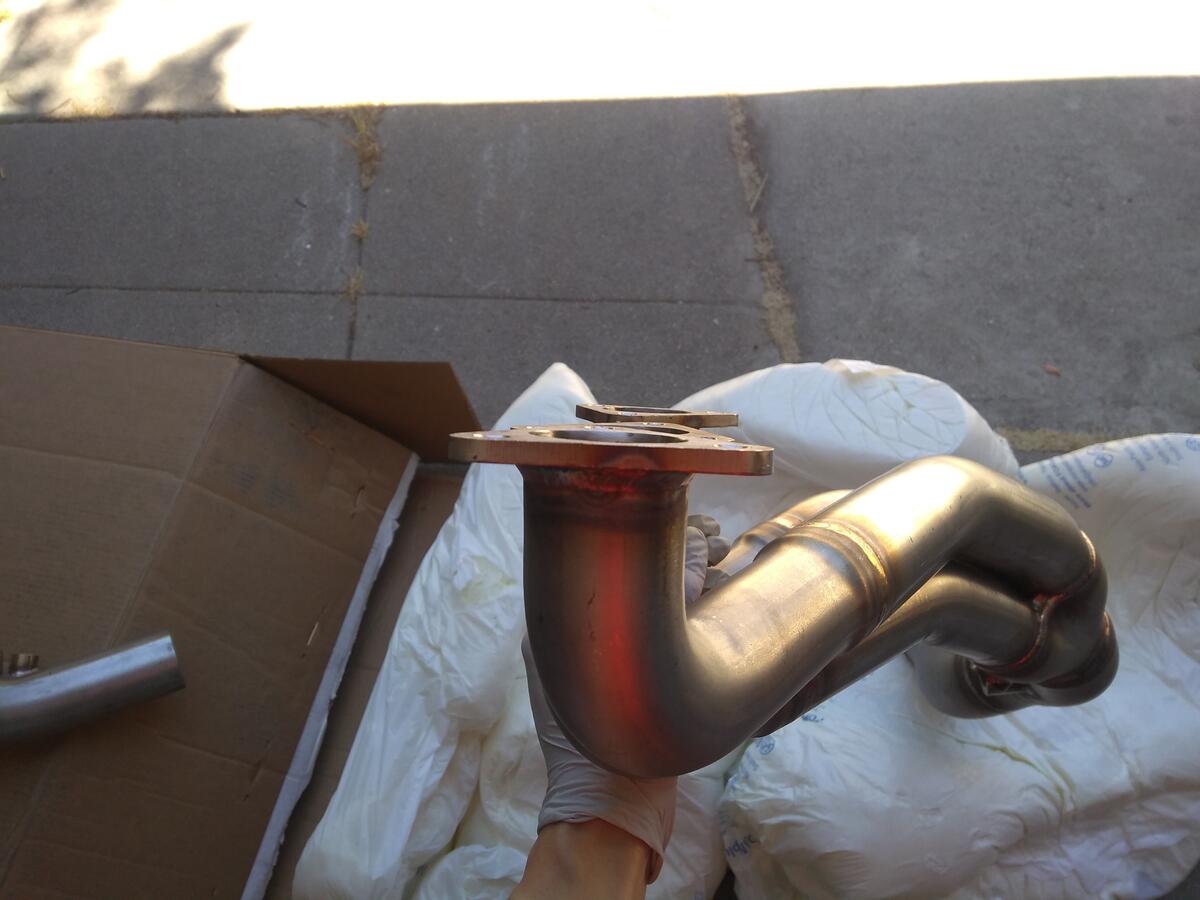

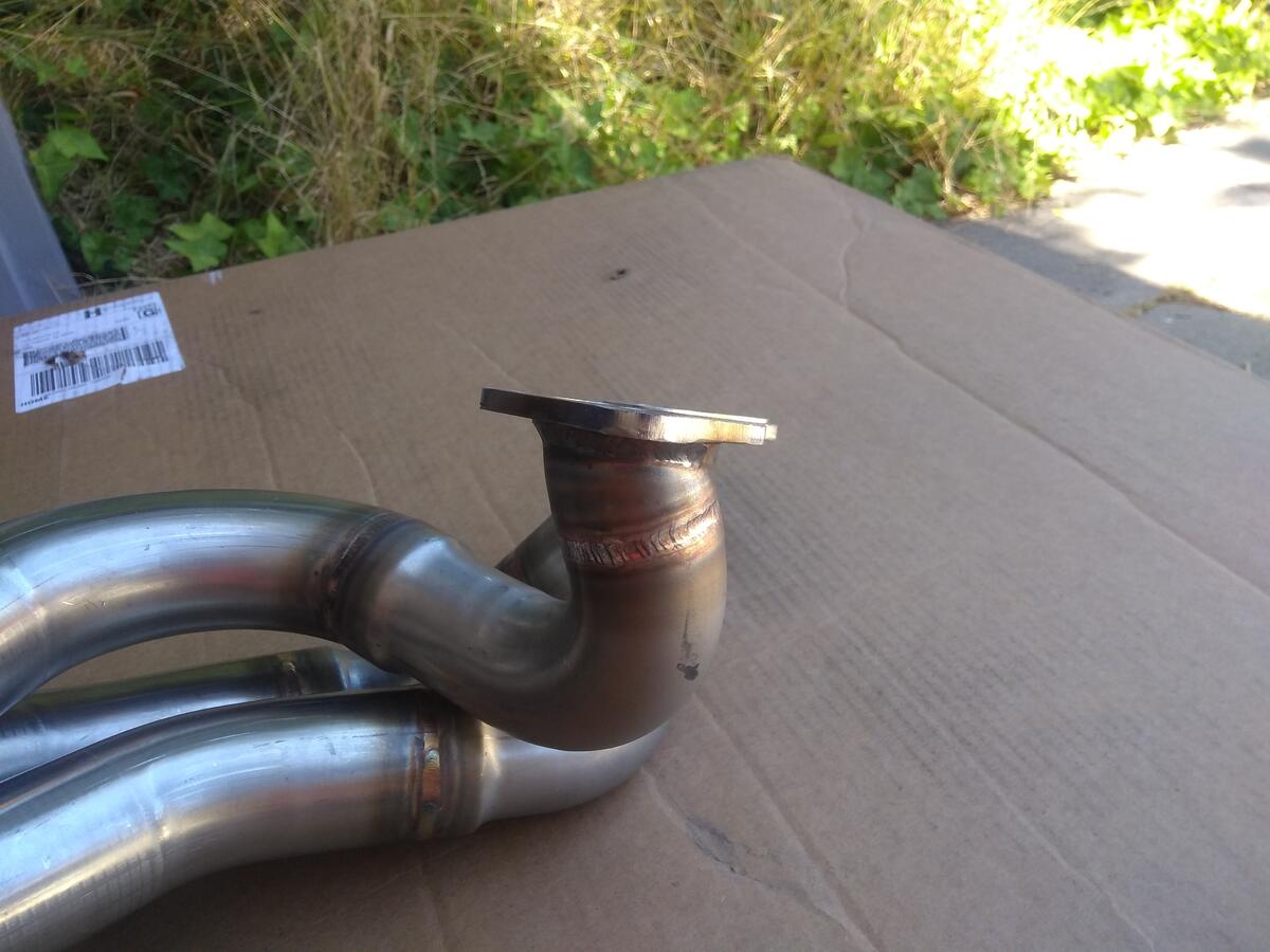

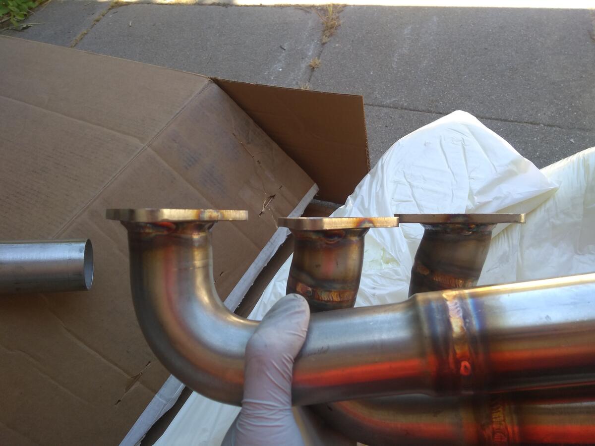

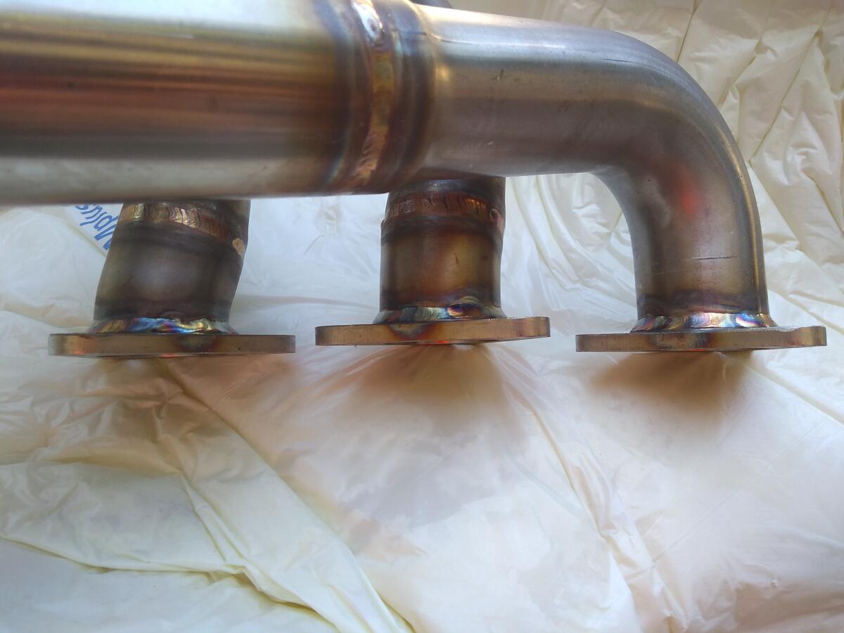

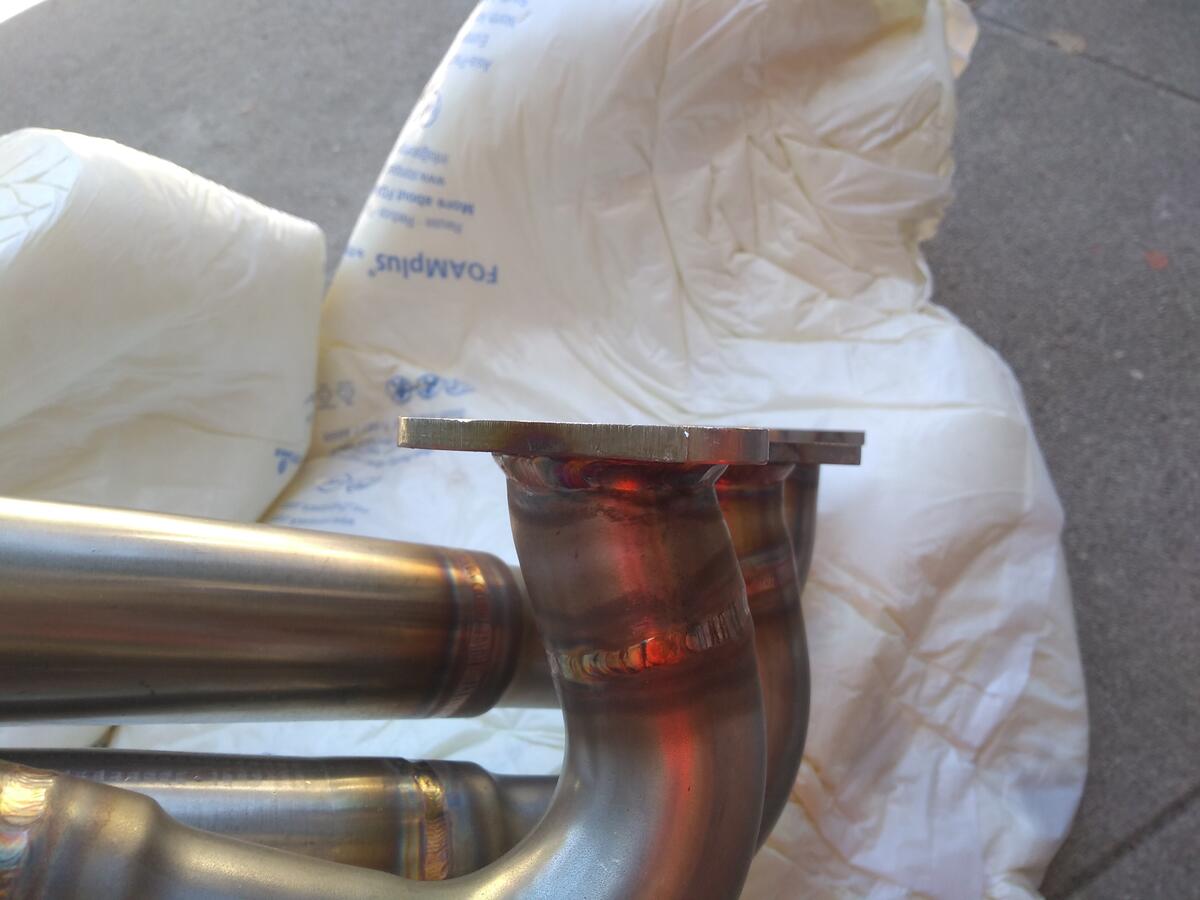

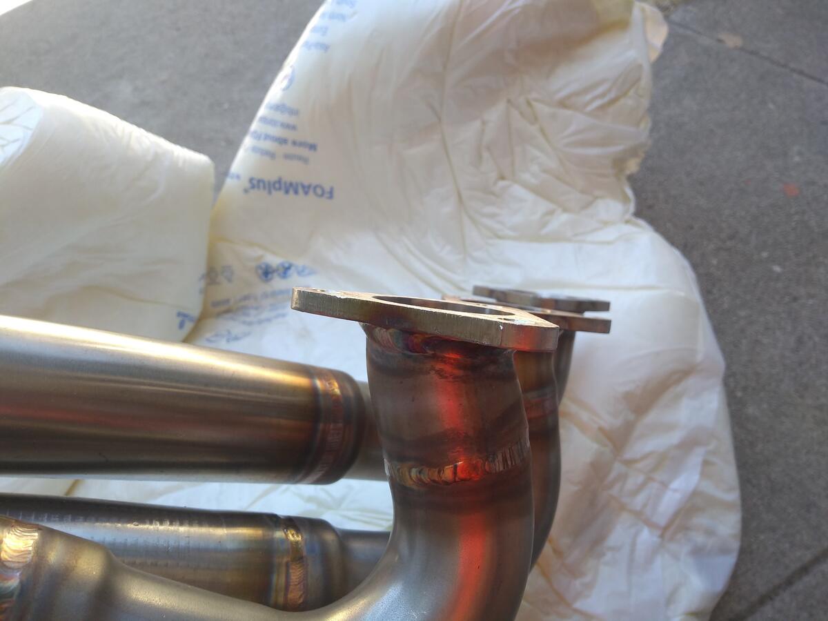

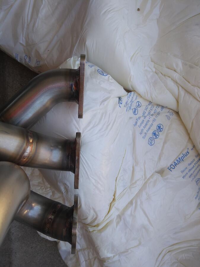

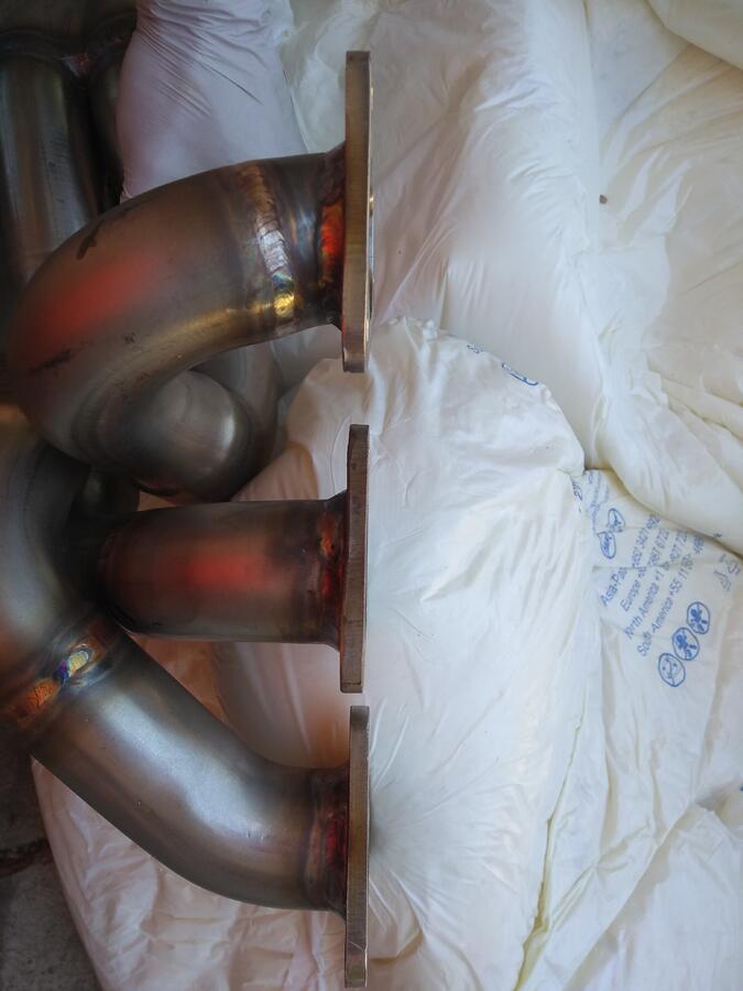

    Are others experiencing quality control issues with their Supersprint products lately? I waited for three months for the oversized stepped headers (part # 044001) and to my disappointment the flanges were WAY off. For the cylinders 1-3 header, the discrepancy was quite honestly laughable and I'm surprised they even passed the QA/QC inspection before packing it up for final shipment. On cylinders 3-6 header, the gap wasn't as bad, but definitely noticeable to the naked eye even without a straight edge. Also they were missing the O2 sensor bungs & copper washers!
    Considering these are the holy grail of performance headers and are $$$$$, I'm really surprised they are suffering serious fitment and consistency issues. I thought Supersprint was known for their spot on fitment?
    Thankfully ECS was kind enough to let me exchange them out; only downside is it looks like I'll have to wait another 1.5-2 months for the next batch to come in.

    It looks like someone took lunch a little early and got them off the jig too quickly, lol. Yeah, definitely get another set.
      Sending them back is the right option.
      But to answer your question I’ve never heard of fitment issues with SS products, but I have heard of welds failing.

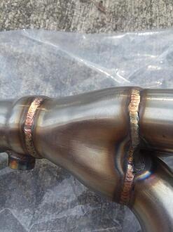

          This is why I refused to get SS headers. I've seen their welds in person and I'm not paying nearly 2k for that. Sorry to see, try and get them to send you another set.

            Even from photos you can see that the welds are not that great.
            Sent from my Pixel 3 XL using Tapatalk
              Yeah given their reputation, I was really shocked to see this leave their assembly line. I really hope I'm not making a big mistake going from the OE euro header & cats setup to the full Supersprint setup. Maybe 2nd time is a charm? I just hope the welds are solid....wouldn't want to do this header job more than once! Fitment wise with the oversized twin pipes and street muffler I'd give it a 8/10.

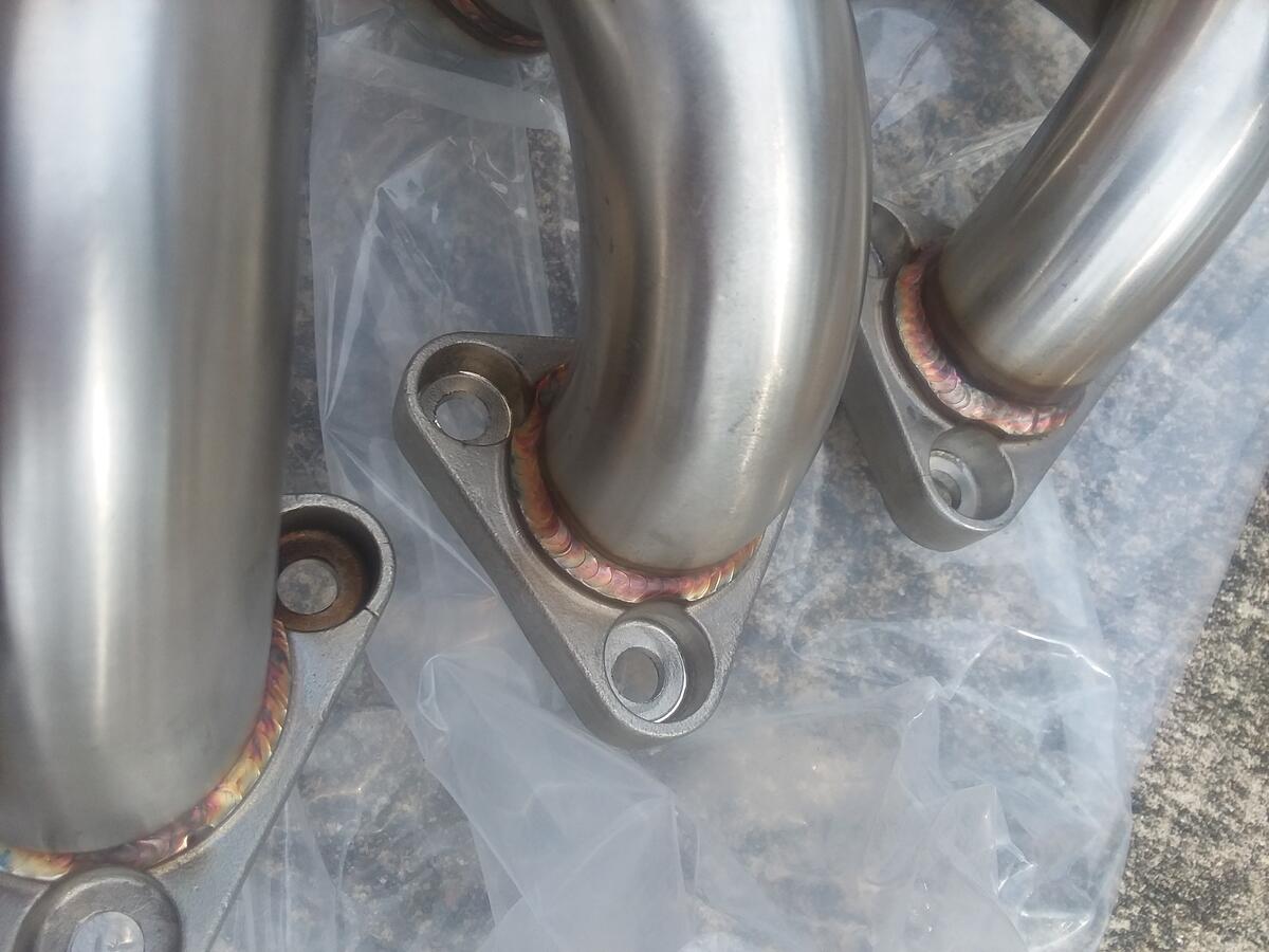

                              True story. Here are my MR headers. The welds are very well done.
