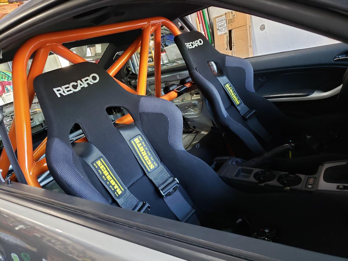

          I have a carbon roof and with factory seats I have a lot of room (I’m 5’10). Never measured but 4” of space is a safe bet.
          Just installed recaro sportsters and will do a measurement for you (wedge mounts and recaro sliders).
                  Very nice cabin

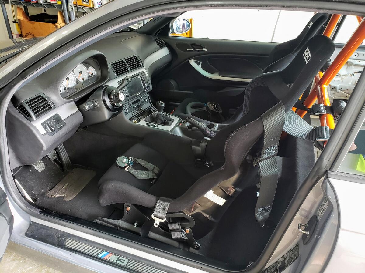

                    Profi XLs with BK mounts...I'm only 5'8" and not too low for me...
                    + sunroof delete...got headroom for days lol.
