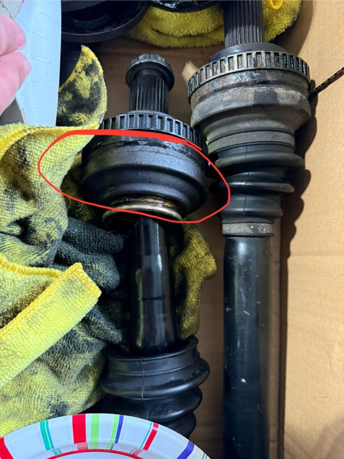

            Does anyone know if the two outer silver & black housings (circled in red in photo) can be separated to thoroughly clean the outer mechanism? If so, how?

              I forget where it separates. IIRC, the boot is attached to a silver flange which is pressed on to the CV housing. Its a single assembly from the splines to the CV housing. I cut the boot off and then removed a couple of ball bearings and separated the CV outer from the inner cage which is attached to the axle.
              I think...its been awhile.

                        Did anyone attempt to remove the outers successfully? The method I heard so far was to remove the outer boot, jerk off the axle into a bucket of gasoline to clear out as much of the old grease as possible, blow it out with an air compressor, repack with grease, and slide the new outer boot through the inner side. If there is a way to get the outer cap off and pull it apart that will be better. 3/4 inner CV's I just pulled were pitted and will need new ones.
                          Its been awhile but I think you pull the boot off and then remove the ball bearings and then separate the CV joint? I just remember getting grease everywhere on everything. I spent more time cleaning up than replacing the boots.
                            So in the pic above, I slid the boot back and checked if there's enough space to get the ball bearings out and it didn't seem like there's enough space without removing the circled cap which is maybe a press fit into the outer CV and can be removed? I'm going to try and clear out the old grease and take a closer look.

                              I think you do have to remove the cap.
