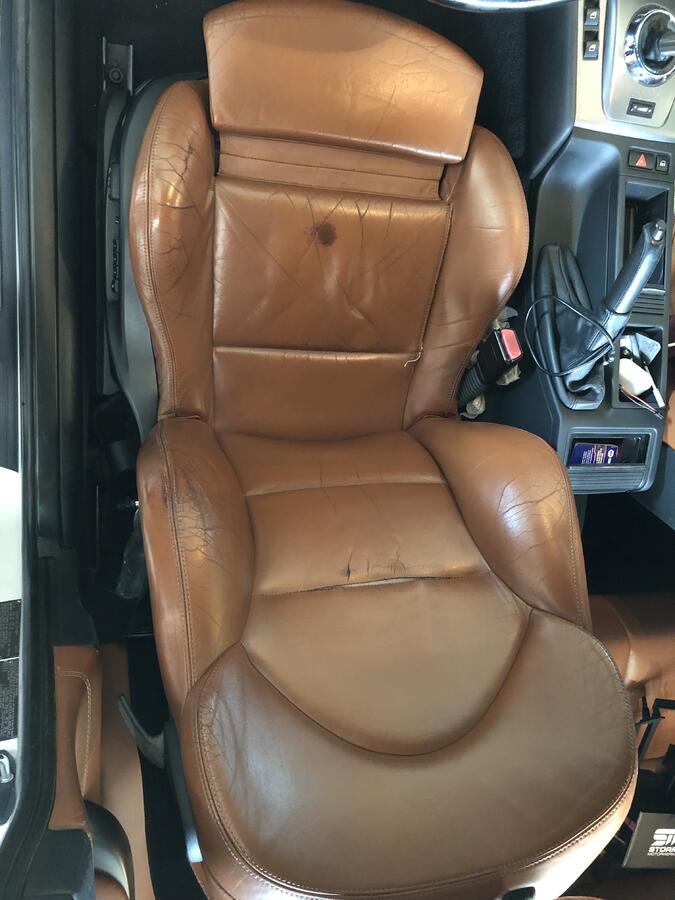

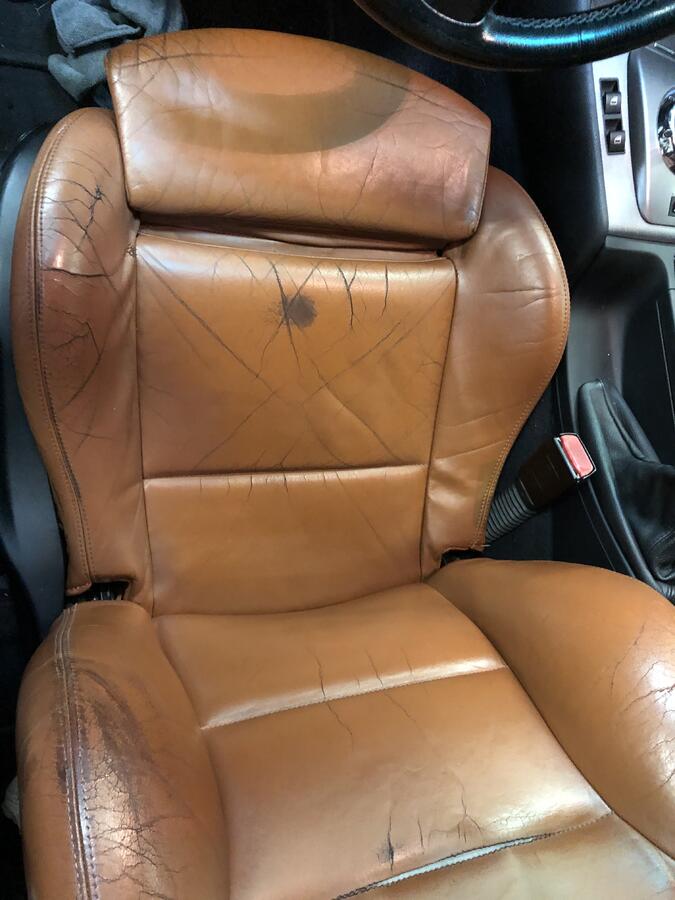

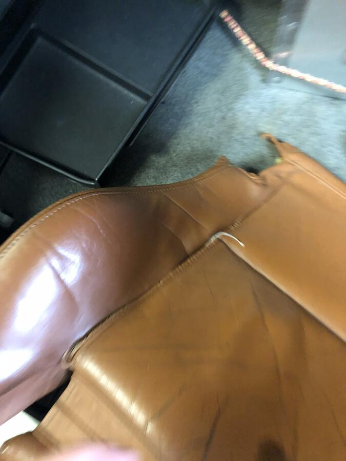

                          Okay so part 1 of this journey completed. Below is a picture of what I started with, as you can see the stitching came apart on the right side where the bottom meets the bolster.

                          Here is a blurry picture of the stitching undone.

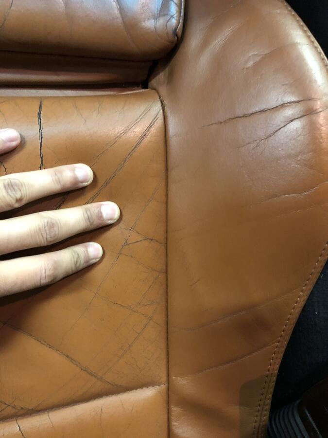

                          My main concerns were two fold, my butt was sore after long drives leading me to believe that the foam was shot, and that the leather condition was poor - both dye and feel.

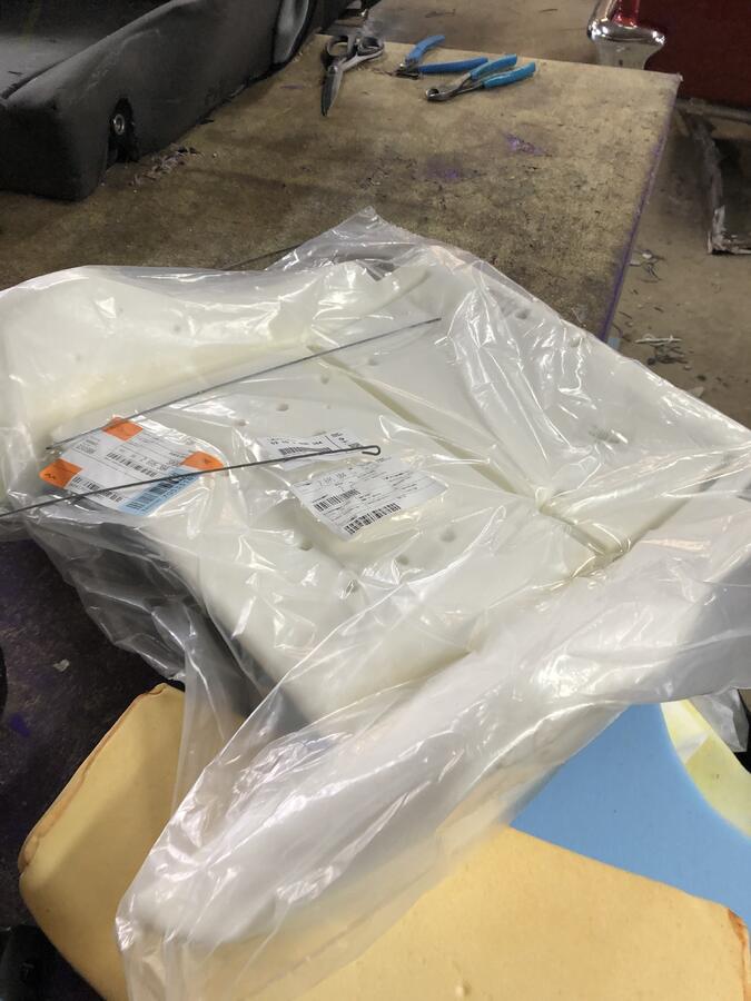

                          I ordered new foam from BMW. TMS and ECS were showing Nov 4 as the shipping dates and a price of about $200. I looked up and my local BMW dealer was showing a price of $210, but there wasn't a shipping date. Called another BMW dealership and they quoted me $300, but would be here the next day. I told them that another BMW dealership was showing as $210 and he immediately matched it with free next day delivery.
                          I was thinking about changing the foam myself, but I had made some calls in the area to see how much they would charge to put it back on the cover. First place I called quoted me $180, the second place said that they would have to see it, the third place I called said that it would be $10 and I could come in the next day and he'd do it on the spot. He did recommend that I condition the leather if it was dry. I spent the next 36 hours with a hair dryer, and Leatherique conditioning and moisturizing the leather. It may not look like it, but it's definitely much softer.
                          When I made it to the upholstery place, I told him about the loose stitching, and he was able to throw it on the machine to take care of that - all in for $20!! Left him a really nice review on Google, will definitely be going back there again in the future.
