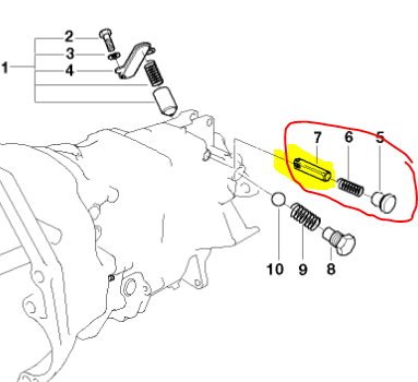

One of those springs was updated to a stronger version, see the photos below.
I copied this from a spring detent post on the old M3Forum.
S6S420G INNER GEAR SHIFTING PARTS
Sequential M transmission Drivelogic
S793A=Yes
01 Repair kit, locking 1 23317506947 $124.60
02 Hex bolt M6X18 2 23317545769 $0.67
03 WAVE WASHER B6 2 23317545770 $0.78
04 Cap 1 23211222729 $6.75
05 Blind plug 1 23317545771 $6.03
06 Compression spring D=1,25 1 23311228397 $1.67
07 Locking pin 1 23311282539 $17.09
08 Locking device 1 23317530787 $27.06
09 Compression spring 1 23311228405 $2.75
10 Ball D=8MM III 1 07119986280 $0.66
I inserted my pickup tool and pulled out the locking pin and compression spring together. Quickly grabbed the new parts: 23311228397 (spring) and 23311282539 (locking pin) inserted the new spring into the locking pin, and put the roller side in first. This will be apparent when you are looking at the parts, it is kind of confusing looking at the diagrams.
I only replaced 1 spring when I did this and it was the one behind the pressed in plug. If you click the Part Number for item #6 (23311228397) you will see that the part was superseded by 23317511337, which is the same part number as item #9.

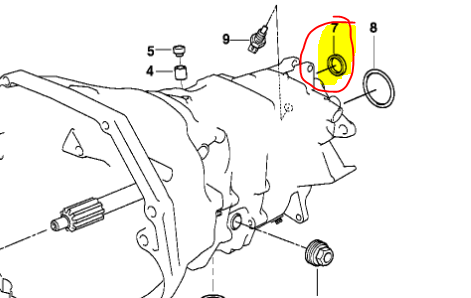

You need two of these, one goes on the transmission end and other on the SMG actuator, it tends to leak SMG fluid on the actuator side.
23127501582 X2 – Shift rod seal on transmission & SMG actuator
Location on Actuator side:
Please note the angle lock pin goes in when replacing
23311282539 x1

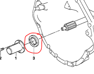

Replace inputshaft & output shaft seal
23121228493 x1 (in)
23121222769 x1 (out)

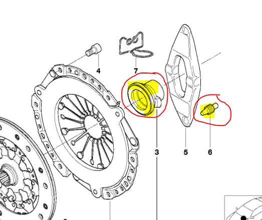

Replace throwout bearing and fork pin
Replace throwout bearing with OEM BMW part!
21511223582 x1 (bearing)
013236ECS01A x1 (bronze pin from ECS Tunning)
21511223302 x1 Clutch fork
