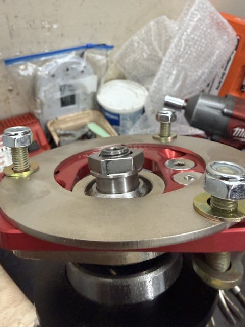

    Does this top nut need to be flush with the bearing? Because I already almost knackered the shaft threads on the otherside try to get the fucker on.

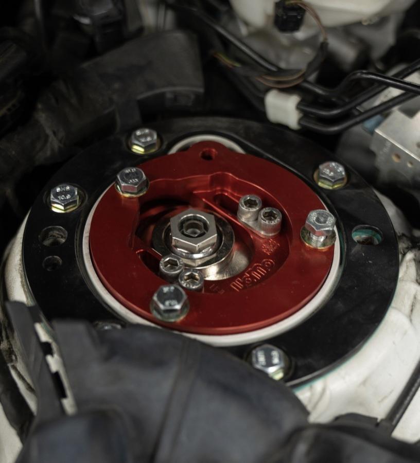

    On this F80M plate, it looks pretty flush to me, but before you break anything , you might want to give them a call.

          Fudge...I guess I need to call them. They are a PIA to deal with...I'll definitely be the moron here. But they make great camber plates.
            didnt you check that it assembled before cranking the hell out of it??
                These are the FCM dampers I've been waiting on. So I got non-M PSS which I guess has a shorter stem that the M3 PSS? Not sure that makes sense because I bought non-M vorshlag plates. Either way, sent an email to Vorshlag and will call them today.
                Why would I do that? Lol
                Yeah, very wrongly assumed it would fit.
                  The inverted monotubes typically have less threads on the shaft/stem. So most likely yea you need different spacer and insert combo for the pillowball. I had to make some spacers for my MCS because the stem was so long.
                  I have had good luck repairing threads on shocks with just a die for any Bilsteins I have boogered threads on. I'm sure Vorshlag will hook you up, excited to see what you think of the new setup!

                      I called Vorshlag and they will take care of getting me the stuff I need. I talked to Jason who was very helpful... I think he's the #2 there?

                              Good news! Vorshlag is getting the bushing I need overnighted to me. Then I just use the nylock nut that came with the struts. Sounds like problem solved.

                              My case was odd. The Bilsteins I had were for a non-M. According to Vorshlag, non-Ms usually have a shorter stem and 14mm threads. M3s usually have a longer stem with 12mm threads. I guess mine had a longer M3 stem with M14 threads.
