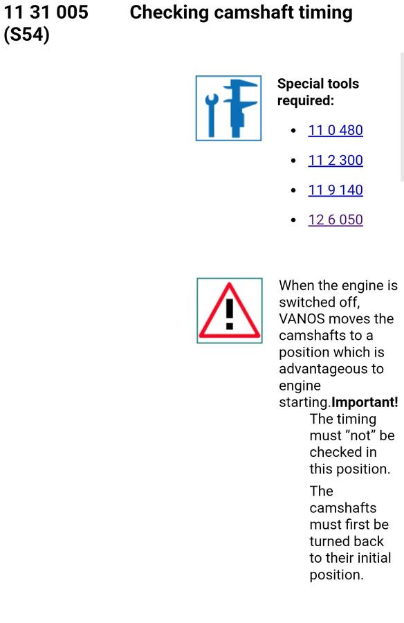

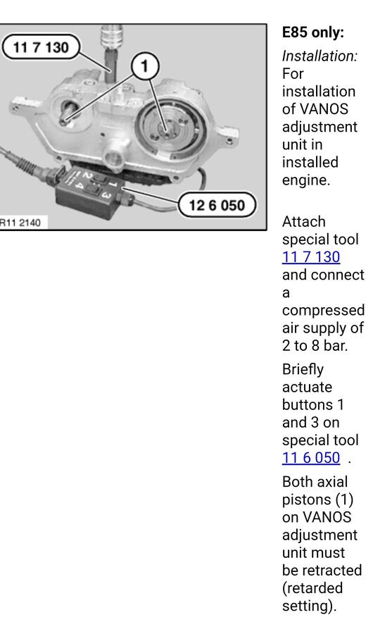

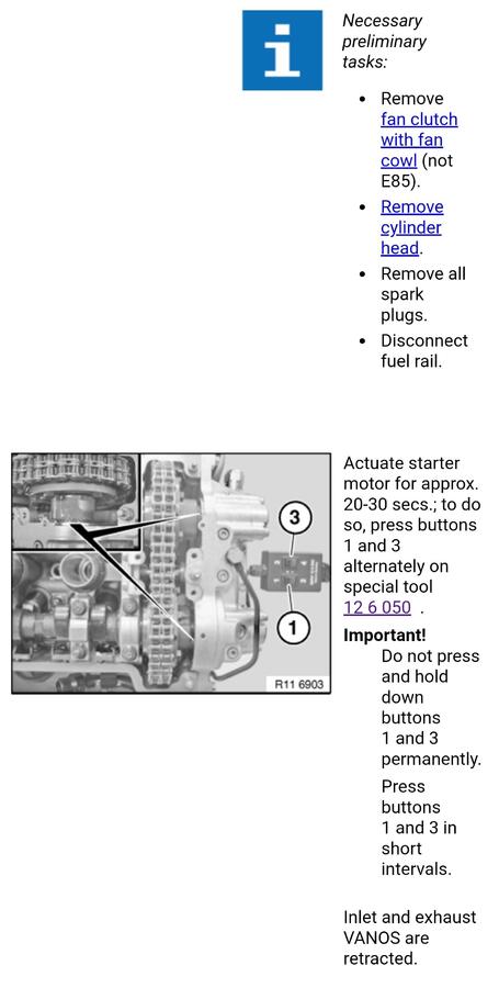

              I looked into the "checking timing" thing out of curiosity and TIS does have a section on doing that. It says to loosen the hub bolts and rotate the cams into their correct positions.
              However, it also says to first connect a special tool onto the VANOS unit to actuate the pistons. This fully retards the cams (by moving the VANOS pistons all the way towards the front of the engine), which is essentially the same thing you are doing when you bolt the VANOS down onto the engine. The cams are not fully retarded when the engine is shut off, as the DME moves them into the optimal position for the next engine start.
              ​​​​Without ensuring that the pistons are at the limit of their travel (cams fully retarded), checking timing doesn't really make sense. So unless you have a way to ensure this, it's best to take the VANOS unit off and put it back on.

                    30 seconds cranking is a long time. Where do you connect this switch to? I rather buy a dinner.
                      #40
                      Yeah not recommending anyone buy it but the op asked.
                      I believe you connect it directly to the VANOS connector and supply it 12v from a battery source.
                        #41
                        So you turned on the switch to active the vanos solenoids and then crank the starter for 30sec? I thought somehow it also activates the starter to crank engine.
                          #42
                          I will admit I don’t know, never had the privilege to use the tool.
                            #43
                            I think you're supposed to crank the engine to build up oil pressure, then use the tool to activate the solenoids.
                            There's others VANOS procedures on TIS that use that same tool, but they have you provide a source of compressed air to the VANOS with it off the car. Those don't have you crank the engine (not that it would do much with the unit off of the car anyway).
                              This makes sense, but it depends on having a good accumulator tank.
                                #45
                                You dont need to crank to build pressure, you need to connect a compressed air supply and power the tool while connected to the VANOS solenoids so you can operate those and fully retard the cams and then be able to disassemble it, or to time it for that matter.
