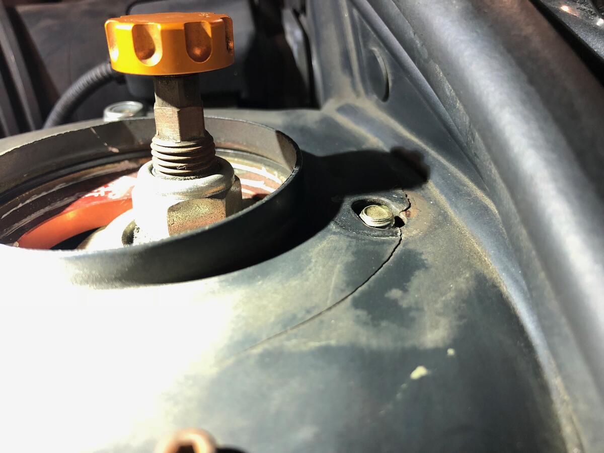

                      Click image for larger version  Name:	IMG_0111 2.JPG Views:	0 Size:	92.3 KB ID:	52575
                      Vorshlag camber plates + reinforcement plates. The tower just cracked around the reinforcement plate. Didn't notice until the strut bar came off for unrelated maintenance.
                        Damn, that sucks. By the way what color is your car? Looks green...

                          It's actually steel grey, I guess it looks green under the yellow shop lights, hahaha.
                              Oh Snap! What the solution? Cut & Weld in thicker plate? Man I thought I was done with reinforcements....
