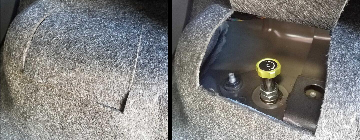

        This was my solutions (minus magnets). The trim is pretty stiff and holds its previous shape. Hard to even notice the flap unless you know it’s there.
          Thanks for the input guys. I was initially going to go with edge trim but decided on the flap since it tucks in really nice. Bonus is that I don't have to buy an 18 ft roll of edge trim, just to barely use 1 ft of it

                Just got around to taking some pics of what I've done, it's not perfect but it still works. The right side is slightly rearwards but is still fine, but damn I should've cut the left side higher. I could still get to the adjuster but it was pretty tight so I had to make 2 relief cuts for a 2nd flap on top. All in all, not the end of the world since it's still pretty stealth, but I'd definitely recommend taking multiple measurements before cutting.

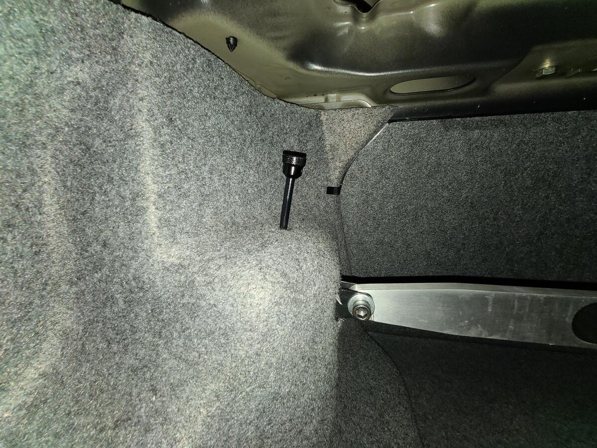

                      Yes. I had already cut trap doors as described above to reach my shock adjusters. From there, I cut pretty much straight down to the bottom edge.
                      The side panels are very flexible, yet sturdy. I twisted the front end of the panel to clear the Mason bar and put the panels in place.
                      For the trunk "floor", I used a jigsaw with a special Bosch blade for cutting plastics (link below). For my car, I cut off 2.5" from the front edge. The overlying carpet mat was cut to match using a pair of sharp scissors.

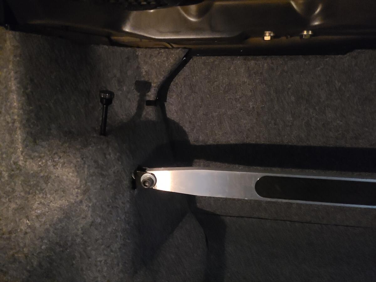

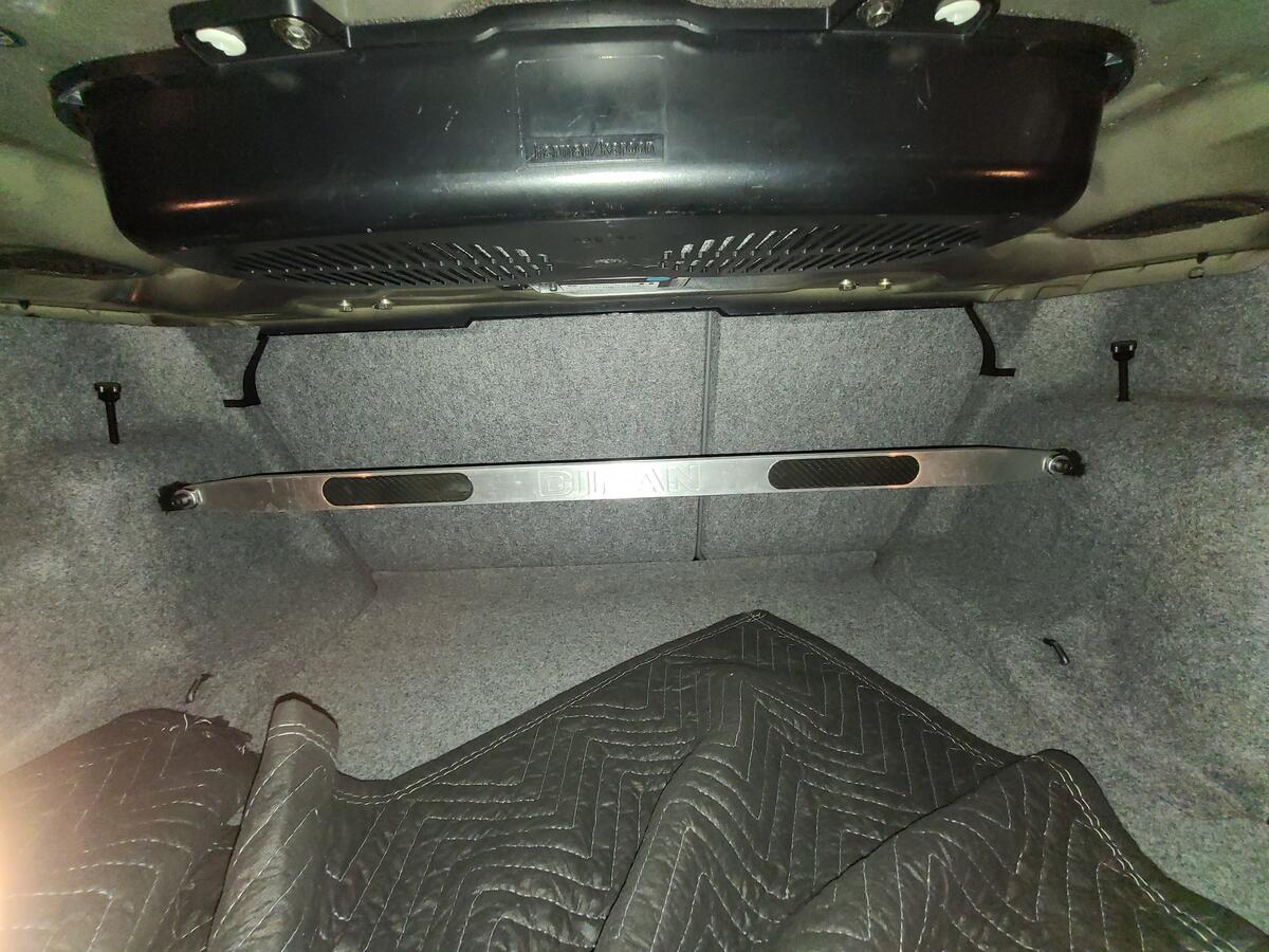

                        Finally got around to taking some pics! The rear strut bar was already installed when I got the car but I did the coilover adjustment myself with a drill bit. I had to do it blindly but after multiple measurements it ended up working out lol.
