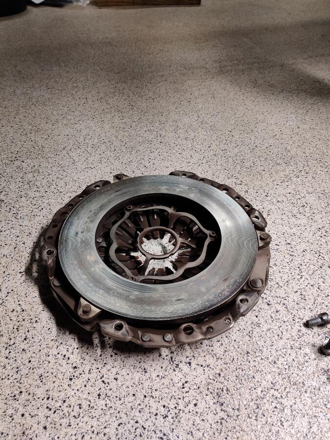

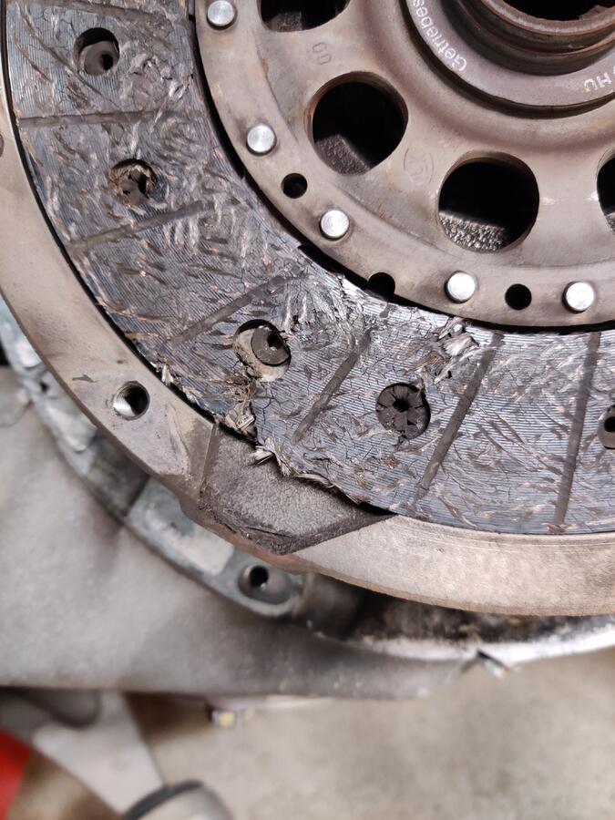

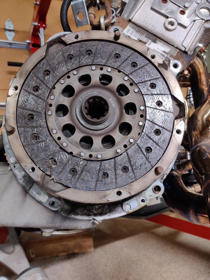

                  Took my motor out this weekend, then detached the tranny (that's the easiest way to change the clutch, right?). My dual mass flywheel / DMF is toast - it rotates easily by hand side-to-side along the rotational direction of the crankshaft, as well as having some slop fore and aft. As a result, my clutch is super toast. I will upload photos from my phone as soon as I post this from my laptop.
                  Most people here go with DMF due to NVH. How much NVH are we talking? In reading jbfrancis3 thoughts on Rogue Engineering's SMF conversion and associated clutch kit (steel 14lb flywheel), that's my strong lean. But is this the same level of NVH introduced by say... solid diff bushings? Or Supersprint Race exhaust? Or is this more of an annoyance / rattle at idle?
                  Some NVH doesn't bother me and I actually prefer it within limitations. By the same token, this DMF last 74k miles. First owner of the car sold the car due to a hip replacement, so I can't help but wonder if the clutch suffered along with that owner. But 74k miles is pitiful for a flywheel.
                  I'm not greedy. I'm good with one mass rather than two.
                  -Casa
