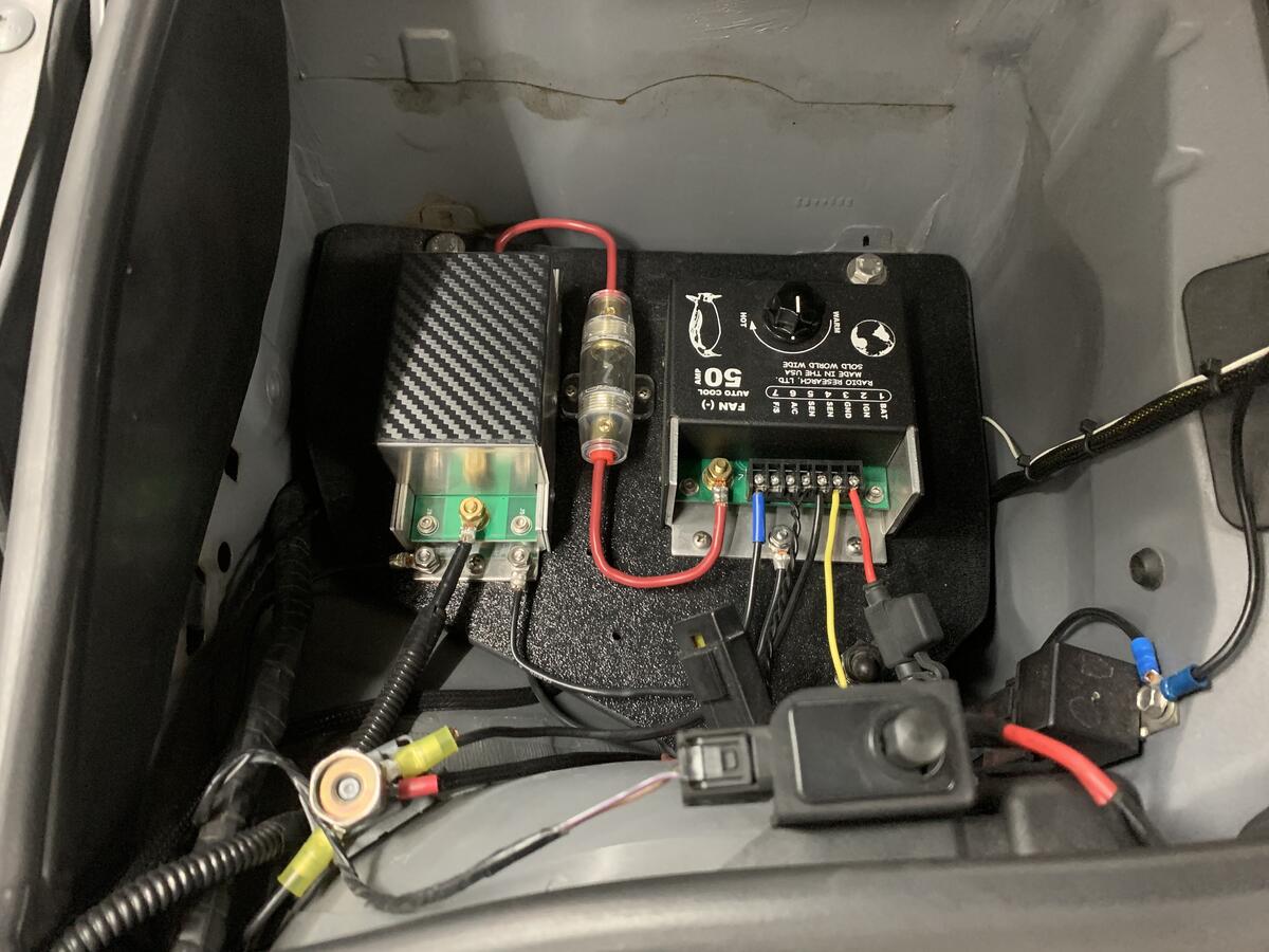

    Currently running the SPAL fan off of a separate relay that I have in the drug bin with an in-line fuse setup-all purchased thru Summit-- it's the only safe reliable way to run high amp draw. Soldering is a necessary evil also. The "on/off switch" for the fan I went with a temperature switch JB welded between radiator fins just above and to the side of the lower radiator hose. I believe the switch setpoint is 185F/ON and 165F/OFF (radiator temp) bought on ebay. This switch parameter has worked very well for me. The OBD coolant temps never rise above 195F while in traffic etc. again, in combo with the AUX fan.
    When I experimented with the SPAL fan only, I did hook up the AUX controller as it's already relay protected and is in close proximity to the fan, so it's a straight 2 wire connection directly to the SPAL, but ultimately had to go back to running SPAL + AUX.

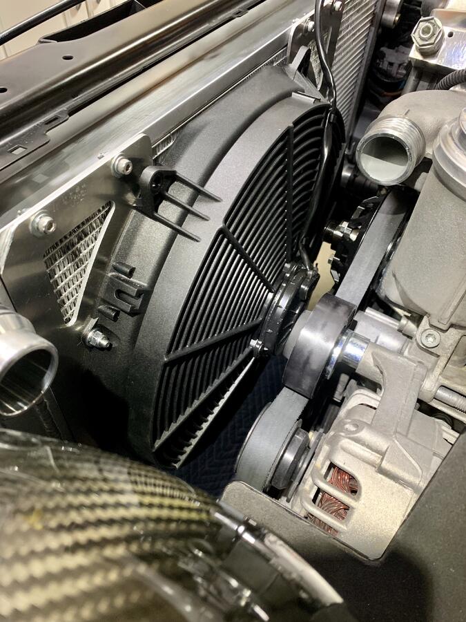

      I really think a shroud has a lot to do with the effectiveness of the electric fan, more so than raw CFM. Both the OEM aux and clutch fans have shrouds that channel air through the blades.
      I'm not aware of any existing electric fan solutions that come with a shroud that fits our rad. Def not Spal/Morimoto

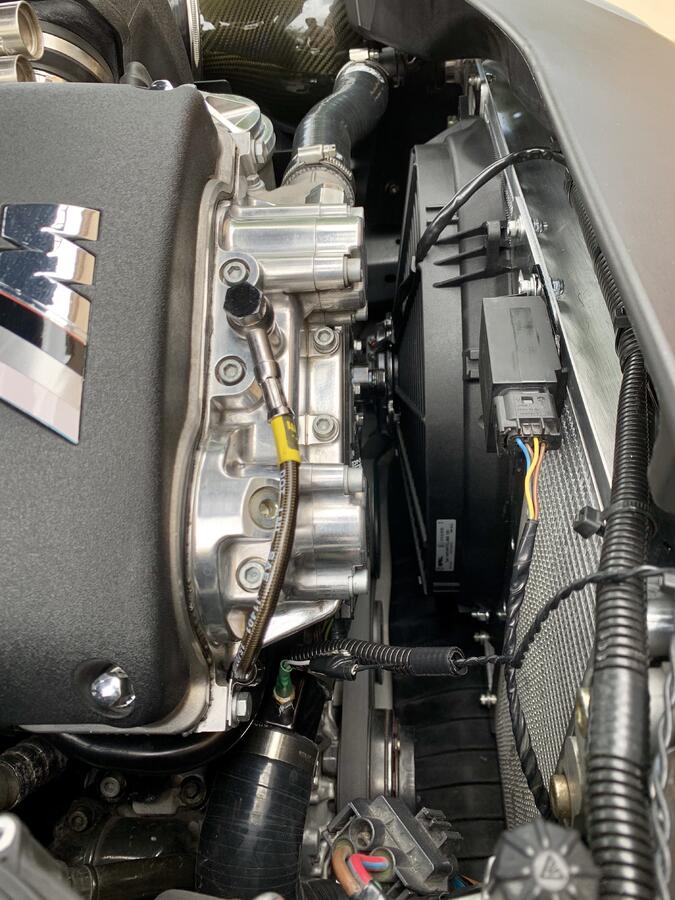

              I'm currently running the Spal 2082 using the N15 fan mounts with the Aux Fan in place. I have a PWM unit running the Spal Fan. I originally ran the Mishimoto fan mounted inside the OE fan shroud. This did work but I experienced temperature creep on HOT days over 115 degrees. So it really depends on your climate, our desert heat is brutal so the two fan setup is a must.

                  I'd ditch the OEM controller. I'm pretty sure it doesn't run at full tilt most of the time. If you delete the mech fan and replace the aux fan, you want to run the fan at full speed as much as possible.
                  I would install a temp switch in the upper radiator hose to trigger the fan. When the fan is on, its comes on 100% which is what you need in hotter climates.

                    Concur with this. The oem aux controller does not seem to drive the puller at full speed.
                    Dedicated fan controller and a shroud like the N15 should be able to generate enough air flow over the rad.
                    For street cars that retain the A/C and use it while stopped I would still recommend keeping the aux pusher fan.
