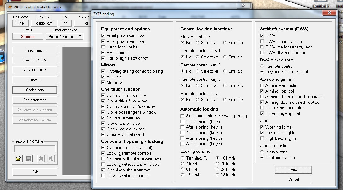

    Recently bought an '03 stripper which I've had to fix a few things on. Trying to figure out if the siren / beeper is broken or just isn't there to begin with. Does anyone know if the siren which beeps when the car is locked / unlocked was optional or part of a package? (or could have been coded out?) I do see on my trunk that it says it is pre-wired for the security system.
    Mine does...because I retrofitted the alarm and coding. Trunk think just means it's prewired.
      Mine beeps 1x.
        IIRC, the audible locking mechanism is a codeable option... I’m sure others here will chime in with a link to the codes. If they don’t by the time I get to a computer, I’ll post them here. Mine does not beep.
        Cheers,
        maw
          Its a Key Option.
            There is a motion sensor in the truck above the battery and a proximity sensor under the center cover on the headliner. If those aren’t there you don’t have an alarm.
            PASOFT 1.4 for the coding options.
            Evolve Eventuri
              It's codeable. You can turn on/off the beep and the light flash as you want for arming and disarming.
              Click image for larger version  Name:	tq2uk.jpg Views:	0 Size:	195.7 KB ID:	55192
              Wolf beat me to it.
                Mine is coded, but it is inconsistent, both when locking and unlocking. In 5+ years I still haven't figured out a set of circumstances that cause either outcome.
