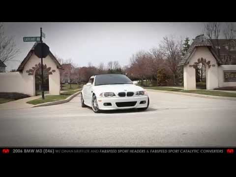

    Is anyone running this setup? I am very tempted to go ahead with catless headers. I don't want a super loud exhaust as I've had a Gruppe M section 3 on my old M3. I just want the power and maybe a little more noise from the exhaust. It's insanely quiet now.
    Here’s a video I took a year ago. It’s super short sorry.
      How's it sound in person? Seems like it added rasp.

        Wonderful inside the car. Outside pretty raspy.
          Don't rip out the stock headers for some power and sound unless the plan is to get a good metallic catted section 1. A DINAN muffler with the stock or euro setup gets it a little deeper and makes a good noise.

                    This sounds really good. So no resonators anywhere?
                      The stock section 2 which has a resonator from factory. The ideal E46 M3 setup is headers, catted section 1, resonated dual-pipe section 2, and muffler just like factory euro cars. A single x-pipe resonated section 2 will change the tone to almost no rasp when fully warmed up.
