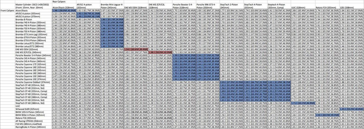

                    The goal of upgrading the brakes is to improve heat capacity, increase pad sizes, improve pad wear rates, and rigidly mount the calipers. There's no reason to increase the clamping force-- the stock calipers can already lock up the wheels with 285 wide slicks.
                    The best performance exists if you match stock brake bias and piston volumes. DSC is also the happiest with that (important even when DSC is off for ABS brake force distribution-- and the brake force distribution is why the e46 M3 is so good at stopping (and why porsche race cars often retrofit e46 MK60 DSC units). The best pedal feel exists when pedal volumes are at/near stock.
                    The Porsche option nicely matches the stock bias and volumes, so the DSC module is happy with it, optimize your braking. The volumes are also very close to stock, making the pedal feel is as good as can be. The 135i calipers get you close to stock ZCP/CSL bias with stock M3 rear brakes, but are way off with the ZCP/CSL rear brakes... and the volumes are off in the reverse scenario. So, you have to either compromise on volumes (feel) or bias (performance), and either way you have a crappy (failure prone) and ugly caliper.

                        thanks for bringing that chart up!!
                        Stock ZCP F&R: 58.0 / 42.0
                        Porsche F&R: 58.1 / 41.9
                        6-Pot F / Porsche R: 59.2 / 40.8 (this is my setup)
                        based on the above I struggle to see how much greater the Porsche F&R would be for me (1.1% difference)
                        Taking the piston heat issues aside for a moment I think we are splitting hairs for a street setup, and the clamping force is still better on the 6-pot.
                        Also, using the actual calculator the numbers vary slightly to what you see on the chart. but again, the difference is very minimal, so if you match rears and fronts accordingly, either setup can work great depending on the end-use.
