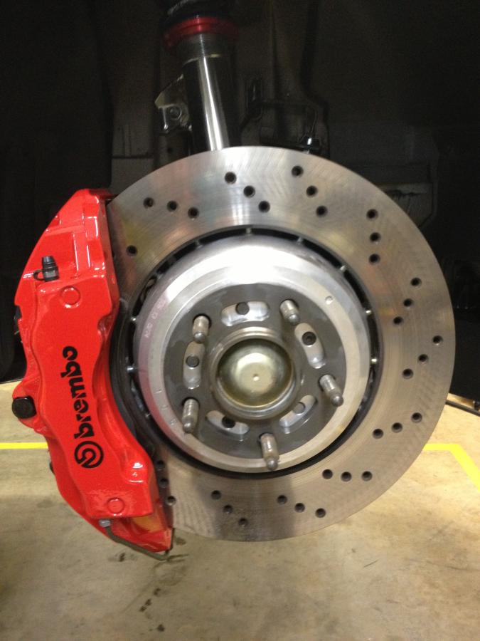

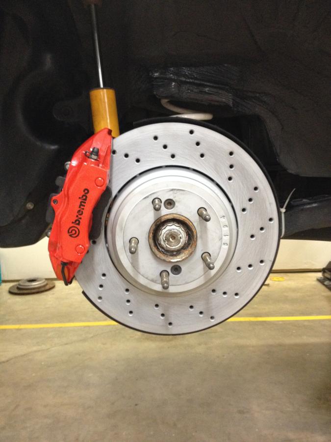

                            P4S is a great street tire that is capable of not comitting suicide while on track. But a proper tire will overwhelm the stock pads in a hurry. I bet if you utilize the R888R referenced above properly, you'll start to see the limitations of the stock brakes (even with track pads). I still hold true that 99% of M3 drivers don't need upgraded brakes (upgraded pads/lines/fluids is all you need), but when you start maximizing R-comps, everything changes. When you add aero, everything changes again.
                              #59
                              Hello! liam821,
                              After reading your post, I found that I have a similar calipers as yours and was wondering could you share your Fusion360 files to me to make an adapter for my e46 m3?
                              I am new here and searching many area and found you post is very helpful to me, thank you for sharing.
                              Merry Christmas!
                              I remember reading that thread. I think the brake bais was pretty off for the 18Z calipers - although they look massive on our cars. If you want a giant caliper, you're better off using Audi B7 RS4/1st gen R8 / Lamborgini Gallardo which are 8-piston monsters. I have a set I was going to use on my Audi S3 but since sold that car - if anybody is interested PM me I've been meaning to sell them. I looked into using them on my e46m3 with OE e92m3 360mm rotors, the brake bias isn't awful, but the company that made an adapter went out of business. I went so far as to design my own bracket in Fusion360 and 3d printed to verify fitment using an old rotor off my e93m3 and it all bolted up and looked pretty good. I ended up not going that route because those rotors are heavy AF, the pads are super expensive (you need 4 pads per caliper), and the e92m3 rotors are only 30mm which is a bit on the thin side for those calipers - they work but Brembo's spec calls for a 34mm rotor. I thought about using Brembo 380mm rotors/hats but they're so expensive and it was getting pretty heavy front brake bias with those massive rotors.
                              Plus, as I said earlier, I also think the Aston Martin DB9/V8 Vantage/Audi 8P RS3 (flipped) setup is the way to go on our cars - they're affordable, look great, good brake bias and pads are cheap and easy to find.
                              I did take a few pictures when I was test fitting the Audi/Lambo calipers though... enjoy If anybody wants the Fusion360 files just hit me up.
                              The billet ones are caliper adapters for an Audi/VW 8V MBQ
                              e92m3 rotors, 3d printed adapters, and Audi B7 RS4 calipers
                              Using a 12mm spacer
                              Caliper dimensions
                                #60
                                "I remember reading that thread. I think the brake bias was pretty off for the 18Z calipers​"
                                Actually it was the 17Z which was bad for our cars. The 18Z paired with the 996 rears were spot on.
