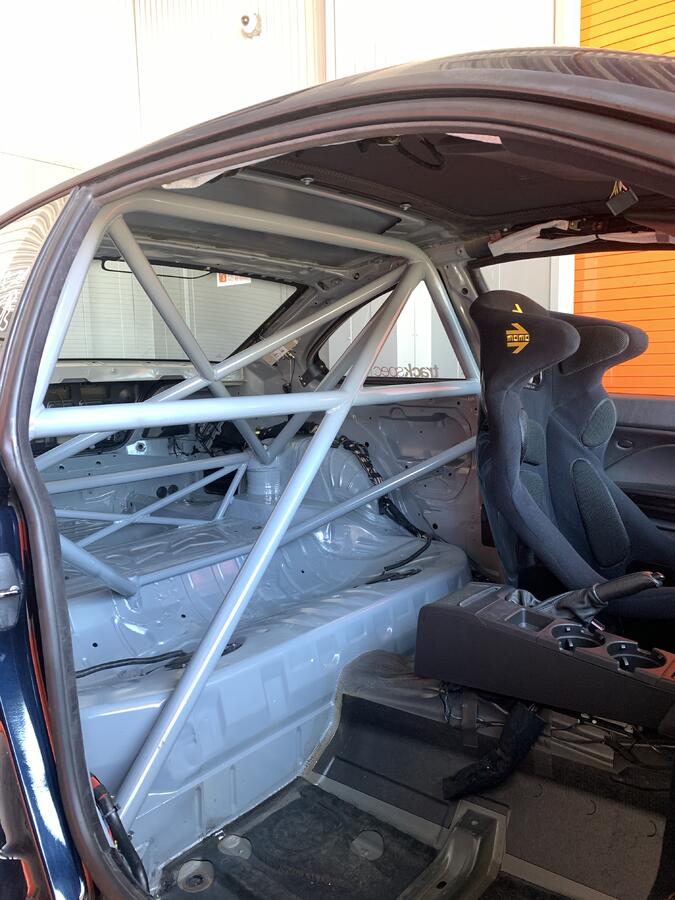

              As as far as weight reduction goes, you shouldn’t feel bad. My cars diet has been substantial since it’s a track car. The only things behind my buckets are a half cage, rear glass and my suspension reservoirs. I deleted the sunroof (AJ Hartman panel, the only true cf option) and plenty of other things. Hell, I even had the parcel shelf chopped out when the cage went in to help offset the jungle gym a touch. Saved like 13-15lbs, I forget which.
              This photo was taken just after picking it up from the fabricators

                Wow, yeah that is gutted! Looks great! Now I don't feel so bad hahaha. I basically have a full stock interior. Removing the sunroof and going with a slicktop CF roof definitely helped though.
