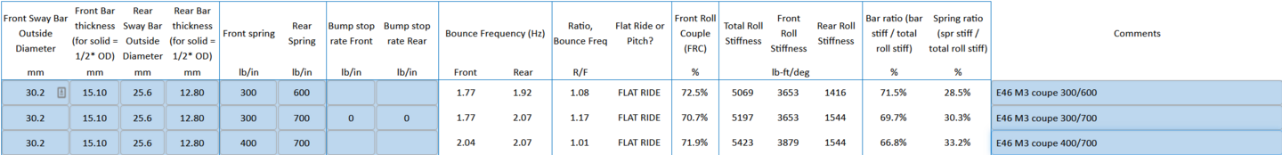

                              After getting jerked around by Eibach I am planning to move to TCK SA. After fooling with the spreadsheet for a while I am beginning to get a feel for it, and have come up with some options. This is strictly a street car.
                              Here are three options that include the stiff Turner sways front and rear:
                              How much different are these going to feel? I see the difference in bounce freq. and bar and spring ratios, but how do these translate to driving feel?

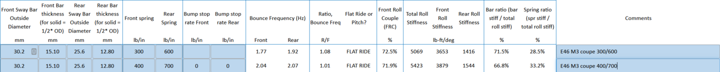

                              Here is an option with a Hotchkis bar on the front (set to med) and the stock bar in the rear.
                              Flat ride in the neutral zone of FRC, but much less roll stiffness, with the springs doing more of the work and the sways doing less. How will this feel compared to the above options?

                                Neutral FRC is ~75. Those a look a bit oversteer biased to me.
                                I ended up in the middle of you’re range— ~362 up front, ~675 in the rear.
