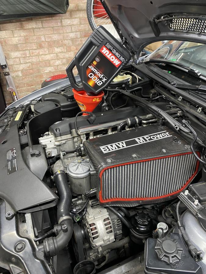

ID:	571384 I've run the Motul 10-60 xpower in my car for the last couple of years, very pleased.

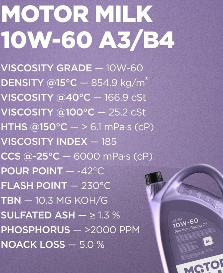

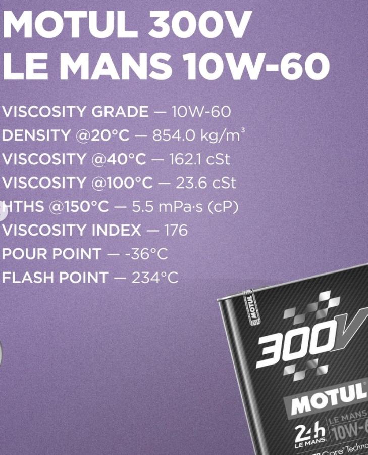

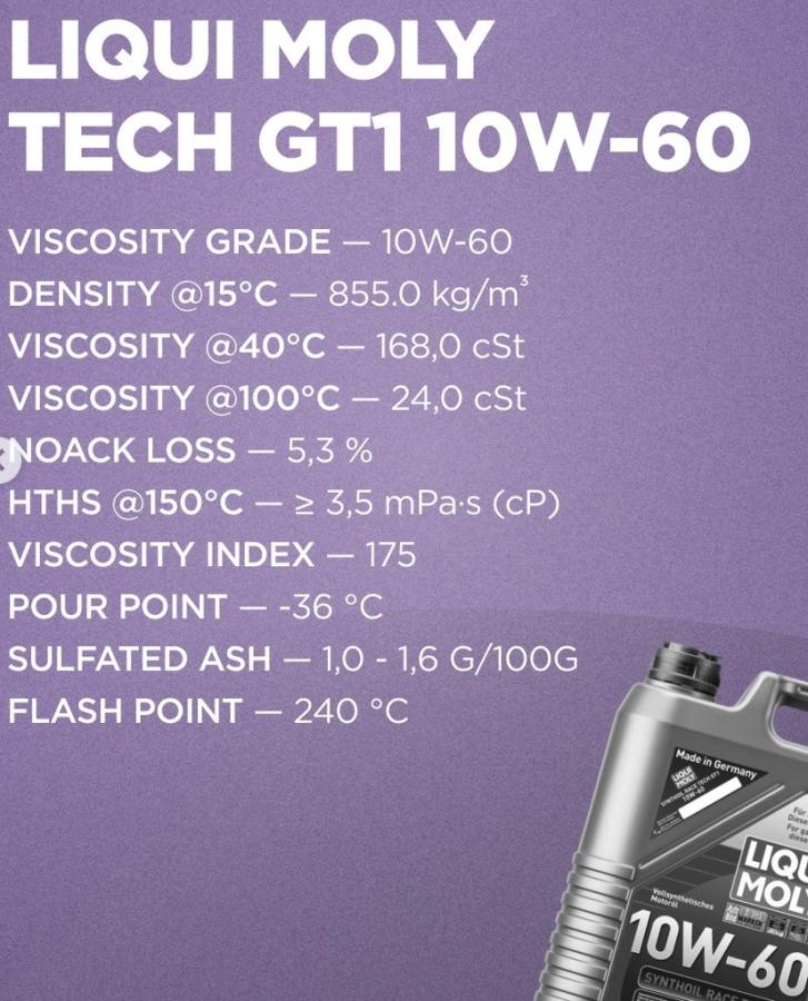

                              Who thought this was a good brand name lol
