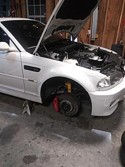

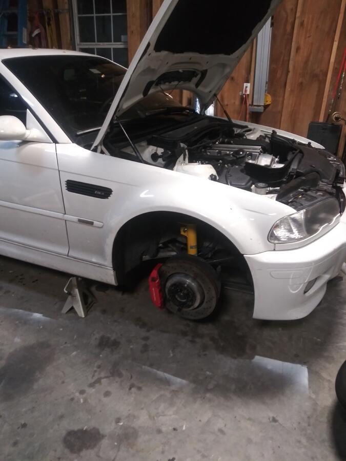

                #67
                Too much wheel gap if you ask me. That's a solid foot and a half.
