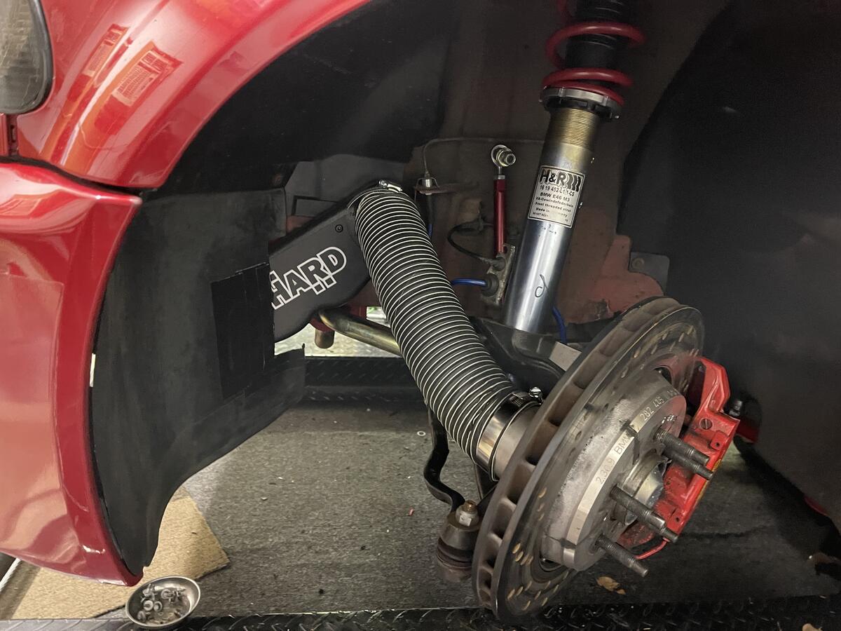

        I haven’t seen anyone fail the H&R rear ride height adjuster, but pretty much nobody runs the H&R coilovers— so that could just be a sample size thing. Mine haven't failed, but I’ve only put ~3000 miles/3 track events on them so it would be pretty terrible if they failed that fast!
        With my H&R based Fat Cats setup set at 60% bump, 40% droop up front, with .5” rake (+- corner balance), I ended up at ~1/2” - 3/4” lower than stock. That either means they’re different shock bodies, or that H&R positions them differently. B8s and B6s have the same bump travel, so that wouldn’t make a difference, even if they were offered for sale on this chassis.
        Click image for larger version  Name:	04981A04-0C0F-4300-89A6-F77E4BE56456.jpeg Views:	0 Size:	293.8 KB ID:	128521
