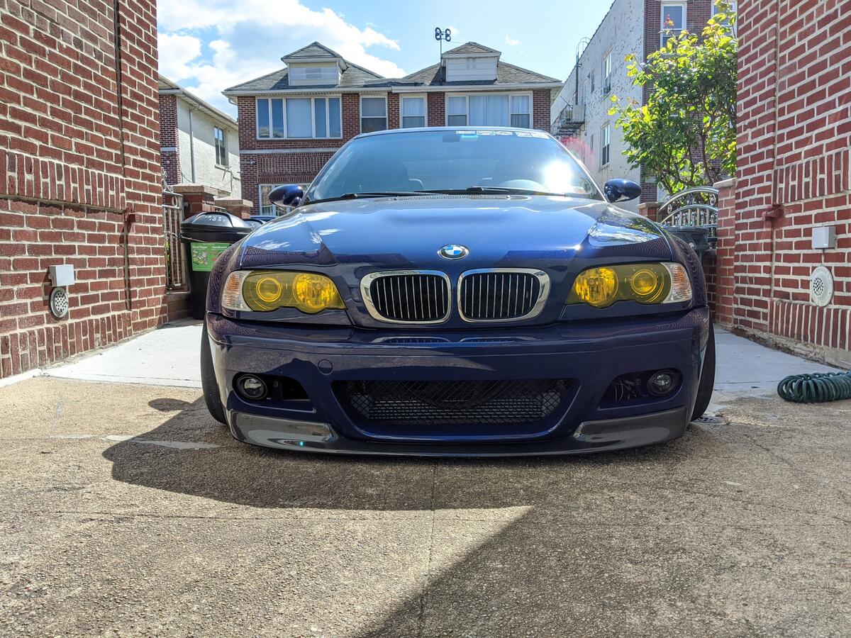

    I have the Morimoto LEDs but light output is a lot less compared to halogens/stocks. Updates the car none the less...
