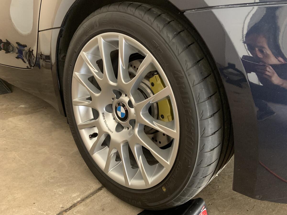

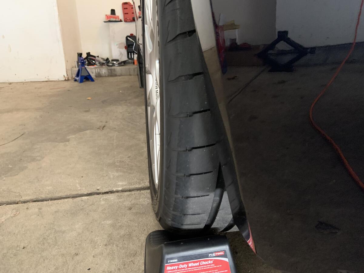

                I have 255/40 and they look square, no stretch. 255 is the max recommended width for an 8.5 wheel. Plenty of e82 people use 255/35 size with their rear OE wheels which are 8.5
                  Do you happen to have pic of what it looks like?
                    I took a few, I hope it helps.
