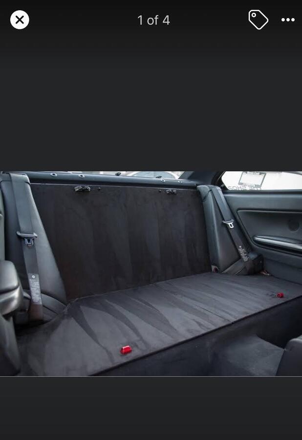

              I got one of the original aluminum ones from the group buy. I wasnt concerned about weight and I eventually wrapped them in Alcantara. Also swapped the OE rear deck back in as I preferred the look. My build thread is gone but here are the pics from my flickr account. Hope that helps.

                Yer nice you did the bolsters and all. When I saw it advertised I did think the rear parcel shelf was a bit of a waste... surely it doesnt actually drop any weight over the stock part... I feel like to drop weight there you would just remove the sound foam underneath the rear parcel cover. The bolsters are kinda nice, although seeing your photos of them installed now I think I would keep my stock ones and modify them to go around my cage and then extend the bottom "tail" of them to fill in that gap between the rear door card and the bottom panel delete and then re-wrap in a anthracite or a leather or other material to match my front eats when i decide what to go with for them.
                I definitely think this delete panel and bottom panel are the best given they are made off legit 3D scans of the car, I just want the lightest incarnation of them as possible before i install... they still haven't responded... see what happens...
