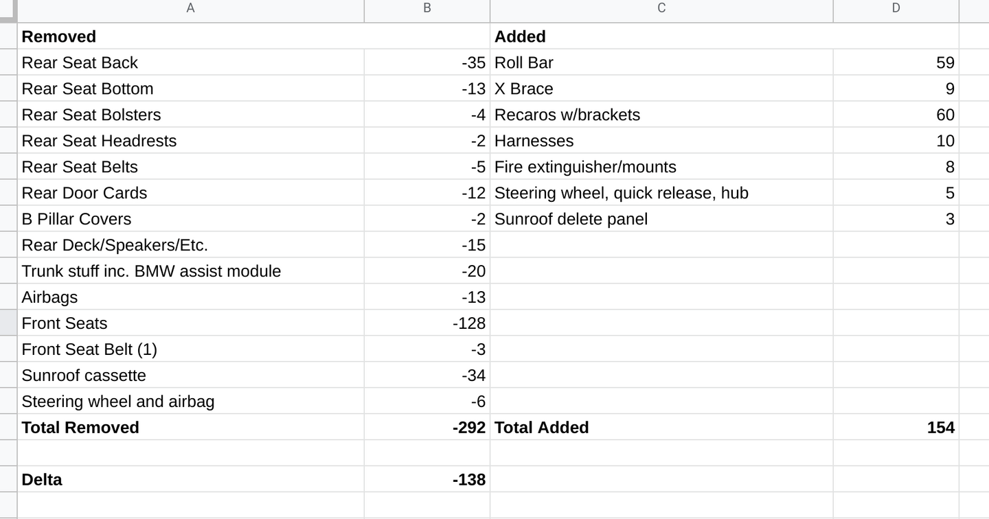

Rear seat cushion is about 13.5lbs.
Driver side seat back is about 22.5lbs.
Pass side seat back is about 12lbs.
I just installed CF sunroof panel and removed/weighed a lot of random pieces.
If of interest, all in lbs (this is prob +/- 1 lb because my scale is not super accurate and to get all the weights I had to weigh myself with/without holding the pieces):
-Rear sub with sub amp assembly 7.5
-Telematics tme unit and entire metal frame driverside in trunk 7.5
-Rear seat cushion 13.5
-Both rear headrests (together not each) 2
-Both rear deck speakers (together not each) 4.5
-Both rear seat backs 34.5 (larger driver side 22.5, smaller pass side 12)

Very helpful in my weight loss documentation, thanks!Originally posted by mrgizmo04 View PostRear seat cushion is about 13.5lbs.
Driver side seat back is about 22.5lbs. Pass side seat back is about 12lbs.
-Fan clutch and plastic blades 4
-Cabin air filter housing with filter 6.5
-Fog lights (together) 2
-Trunk lid panel and tool kit 4
-Roof rack (with bike bar) 15
-2x trunk inside lights - negligible
-Cabin air filter vertical block plate on firewall 4lbs
-Roof liner 3.5lbs
-Prep for roof liner to come out - lights, a/c pillars, sun visors, rubber seam for sunroof glass, oh shit handles, clothes hooks, 8lbs
-Sunroof glass 14
-Sunroof cassette 16.5DD: /// 2011.5 Jerez/bamboo E90 M3 · DCT · Slicktop · Instagram
I'll prob start a thread would be useful. I have other parts of the car that I can weigh too.Originally posted by Tbonem3 View Post
