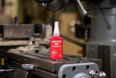

            Subscribed for review of this kit. I assume the loctite in the kit is for securing the adapter to the factory knuckle? Id really hate to break red loctite every time I had to remove the caliper.
            loctite doesn't make bolts tighter, it just prevents them from loosening from heat or vibration.

              Not all loctite is the same. What you are saying is true for blue loctite. Red loctite is very hard to break free without heat.

                  I disagree. I've used a lot of red loctite in my day, I've never found it more difficult to remove those bolts.
                  red is for use in high heat applications, blue is not.

                    I disagree. Every fastener I have ever used with red loctite applied has required heat to be removed. The maker of Loctite also recommends using heat when removing:
                    Without applying heat to the assembly, it’s likely that over time, a bolt would break before coming loose.

                        I've used tubes and tubes and tubes of the stuff on brakes, drivetrains, exhaust, and engine components. I've never used heat to remove.

                            Agree to disagree I guess. I have only ever used the red loctite on wheel studs and floating rotor ring hardware, and front diff bolt. All required heat to remove with hand tools.
                            You sure you're not confusing it with blue loctite that also comes in a red bottle?
