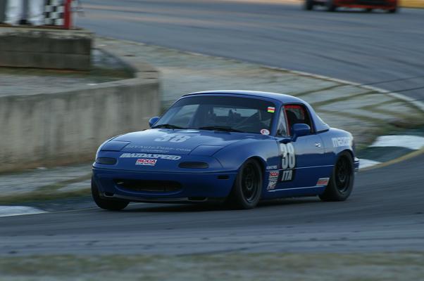

                I mean, I spent 7 years racing with SCCA in SM/ITA, built multiple cars for myself and others, crewed/co-drove on multiple winning enduro teams, and finished 4th at the ARRC sprint race and 1st in the endurance race. but I guess I'm a canyon boi.

                      Do Miatas have brakes? I thought they just lifted.
