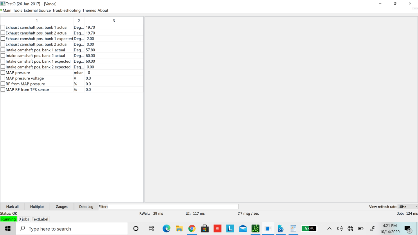

    At idle the exhaust cam is at approximately 19 degrees when I understand it's supposed to be at approximately 0. The intake cam is at approximately 57 degrees at idle and seems to be fine on all of the tests that I've run. Using Tool 32 the intake cam passes all of the Vanos tests but the exhaust cam fails.

    I've attached screenshots showing the ISTA fault codes and the vanos test results using Tool 32 and Testo. I've also attached a video showing the Vanos data running Testo. You can see how the exhaust reading bounces around between approximately 19 and 8. I was wondering if it could actually move around that much that fast or if that's possibly an error.

          The error code says EX has 19* advance, but using the bridge tool it was confirmed correct timing. I have trouble seeing how can this happen. Since you had opened the valve cover multiple times after the first trial, did you use the bridge tool to verify the cams timing after engine running with EX = 19 at idle? It should show that the EX not lining up with the bridge pin. Was it about 19* ?
            One way to explain your problem is that you had set the timing correctly, but during engine running somehow the VANOS cannot move the EX cam to zero degree, such as the solenoid valve cannot release the pressure for piston to move back after the piston had advanced in previous cycle.
