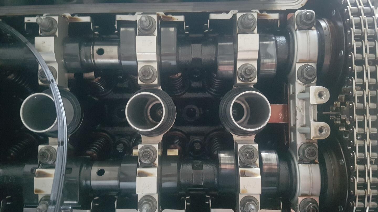

I was finally able to get back to working on my car this weekend. I put the old exhaust hub back in and ran the car briefly at idle but still got the same codes with the exhaust cam being off by a little less than 20 degrees. Same thing as before as It would actually constantly bounce around from approximately 10 to 20 degrees.Originally posted by sapote View PostIt’s 19 crank degrees retarded instead of zero, which means if the EX cam is marked for reference after engine turned off, then open the piston cap and solenoid plate removed, try to advance the EX cam with 24mm wrench while pushing in the piston, the cam should advance 19/2=8.5 cam degrees to its max position. If this is confirmed then we know what’s wrong.

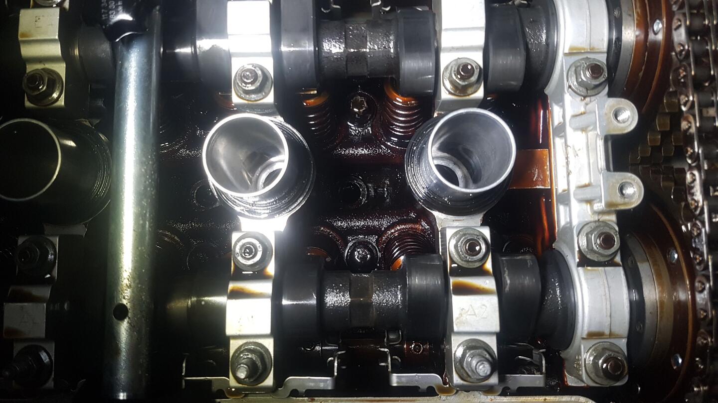

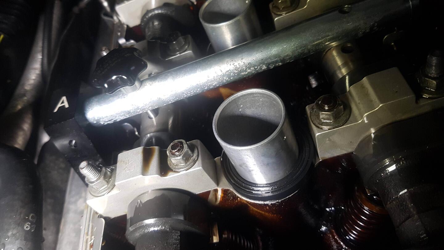

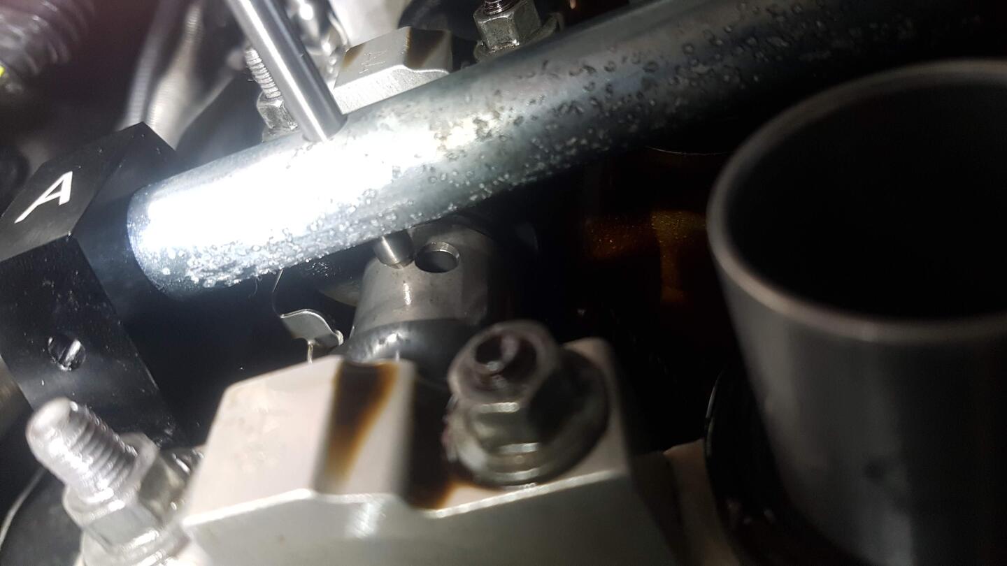

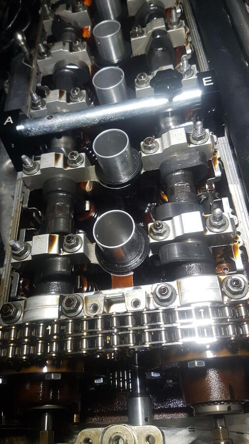

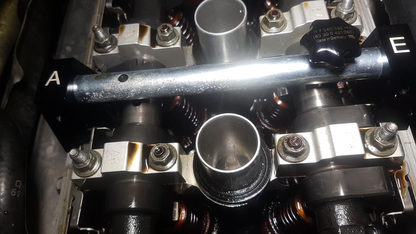

I took everything apart again and after locking the crankshaft at TDC I was able to get the pin in the timing tool for the intake side. The exhaust side pin wouldn't go in as the cam was rotated too far clockwise.
I then tried to rotate the exhaust cam . It was extremely hard to move in either direction. The exhaust spline shaft was already deep in the hub. Rocking the cam back and forth with a significant amount of force and pushing on the spline shaft I was able to move it slightly further into the hub. I then rocked the cam back and forth to bring the spline shaft all the way back out of the hub. At that point I was able to get the pin in the timing tool.
Again it took a significant amount of force and a significant number of very small rocking motions to finally get the camshaft rotated counter-clockwise to be in time.
The first two photos are with the crank locked at TDC before rotating the exhaust cam. The remaining photos were taken after rotating the cam to be in time.
