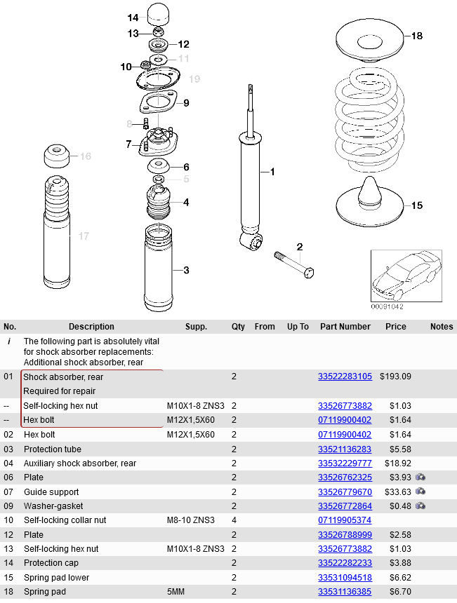

    Note: you can do an okay corner balance without ride adjustable coilers using BMW's various spring pads from different e46s (the pad that goes between the spring and the control arm). This is what I've done on my M3 wagon (which is on Dinan springs with Koni yellows). Spring pad options are as follows:
    5mm # 33 53 1 136 385
    7.5mm # 33 53 1 136 386
    9mm # 33 53 1 127 224
    10mm # 33 53 1 136 387
    From Obioban's sticky. This pad goes underneath the spring I believe.
      Just look at pics of it. Google it. I just bought some lowers, it's the spade. Top is a donut.

                  Tbone - thx I see it now. Didn't realize we were already on 5mm. Anyone looking for a picture...
Name:	Screenshot_2020-10-27 RealOEM com - Online BMW Parts Catalog.png
