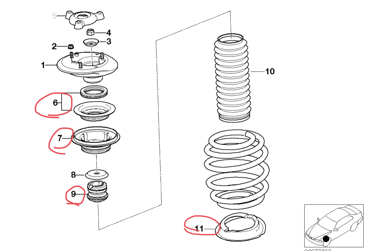

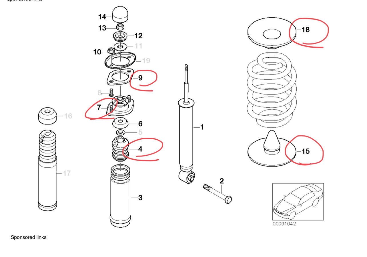

    It feels like Konis yellow are the consensus here. I have Eibach springs too waiting to install and I'll likely go Konis. To tag onto your post a little, it would be helpful to know (including struts) what all needs to be purchased at the same time for this install?
      I would do the ones circled in red. If the strut shaft boots are damaged you will want to replace those as well. Mine had 115k miles and were fine.
