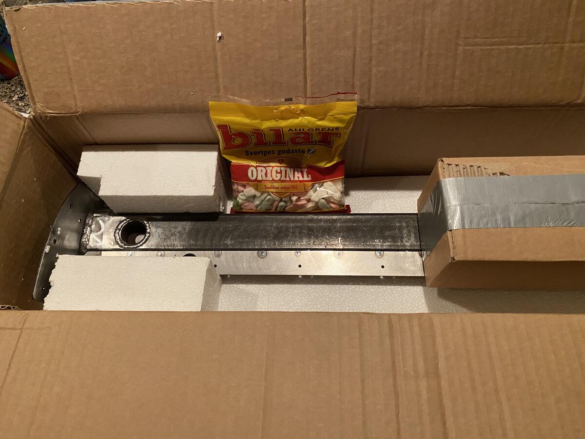

Got my vincebar today
    To be honest, I was not expecting a bag of candy with it😆 I can’t wait to try them.

                  Thanks for posting this. Where did you source this from? Thanks!
                    Vince sells them on Facebook. https://m.facebook.com/pages/categor...RnDnews/posts/
                    I think I also remember seeing one in the classifieds.
                      thank you!

                            What's the total weight?
                              Those candies are usually 4oz.
