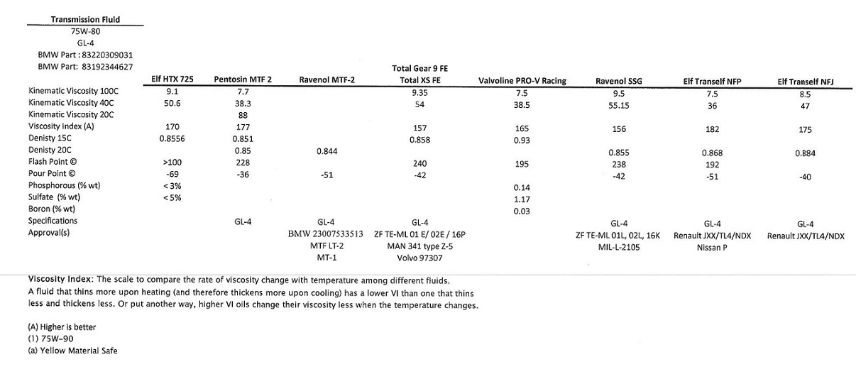

                          One thing Ravenol wouldn't do is divulge spces on their MTF-2 even with a phone call and e-mail request. Nor would Fuchs. They do, however, publish the specs for Ravenol SSG. Go figure.
                          Attached is a copy of synthetic manual transmission fluid specs for the ZF 5-speed (for those of us who've done a swap) and the Getrag 6-speed. Both the ZF and Getrag require a GL-4 fluid as the properties of most GL-5 fluids are not good for the "yellow metal" synchros.
                          I'm happy to e-mail anyone the Excel spreadsheet.
