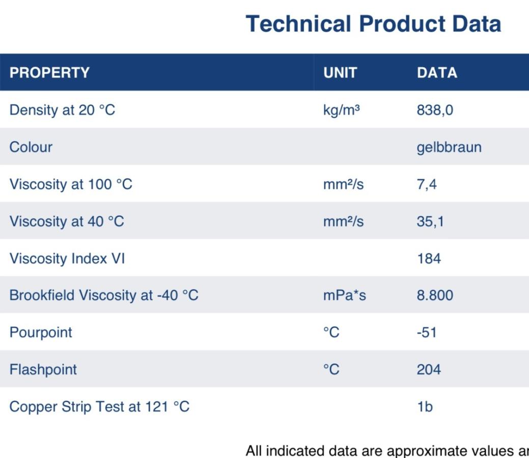

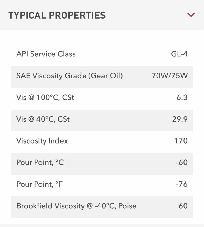

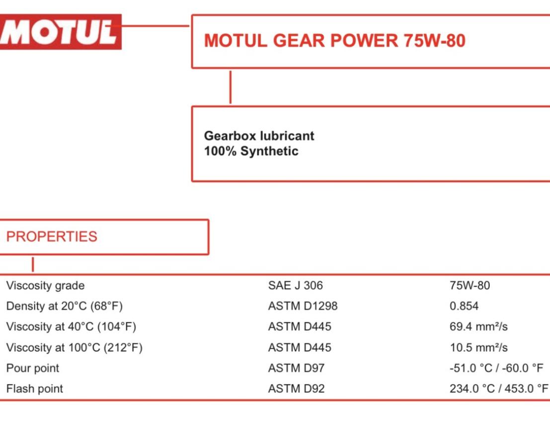

            But like im sure happens to alot of us, i was in bed thinking about this more and went deeper looking into the technical specs of that, the Ravenol mtf-2 75w80 i was running, and that Motul Gear Power 75w80 GL-4 that was suggested above. I ended up buying 2 bottles of the Motul as well and figure ill try the motul first and just amazon return the redline worst case.
            But digging deeper into the specs of the Motul it seems to be quite THICK, even compared to the Ravenol its nearly double the cold viscosity and even higher than Redline MTL, while the MT-LV is the thinnest viscosity wise (but makes sense as its a 70w75) which makes me wonder how good its protection is for track use. Im still going to try the Motul first, but seeing how thick it is especially cold im concerned ill have notchy hard shifts until warmed up, but maybe will be fine at track temps and potentially better protection? Specs attached for all 3: MT-LV, Motul, Ravenol
                Good catch! I checked the two other Motul 75w80 gear oils, and they also seem to be similar in thickness.
                For track work, I think I prefer the increased thickness, but since you also drive on the street, it could grind when shifting at colder temps (edit: northern cold, probably not South Florida cold as Tbone pointed out haha)
