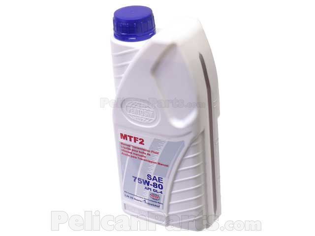

        The Pentosin we're talking about is this, right?
        The proper Pentosin fluid (photo below), which as Obioan noted, is no longer made, is MTF-2: http://www.pentosin.net/specsheets/Pentosin_MTF-2.pdf
        Feff
        Click image for larger version  Name:	MTF-2.jpg Views:	0 Size:	16.0 KB ID:	6828

          No, the correct pentosin is discontinued at this point. NOT that one!
          Gotcha. I can still find it on RockAuto and other retailers, but I'm guessing once it's gone, it's gone? I'd hate to have to shell out for OEM fluid at that point.
            FCP Euro also carries it.
            https://www.fcpeuro.com/products/75w...mw-83222339219
              Ouch, RockAuto has it for less than half that price.
                Yeah, the places still selling it are selling new old stock.
                I bought too much and have been selling it for $10 per bottle plus shipping, if you're interested.
                  $10 per liter bottle? Damn, let me PM you!

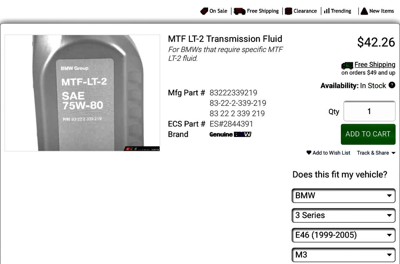

                              Why not use the real deal? ECS currently shows it on their website for sale. 🙄
                              Click image for larger version  Name:	C585B3C9-C617-41A4-A762-B24EEABE6117.jpeg Views:	0 Size:	90.5 KB ID:	7653
                                ^ Does it still exist as a BMW part? In that case, I'd imagine FCP Euro should be able to get it, too.
                                Or does ECS just have a crapload of that stuff in stock from before?
