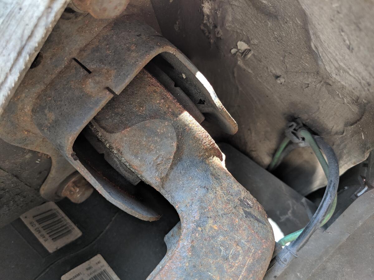

      When I first got my car the rtab brackets were wrong installed. They need to be inside the pocket. Maybe thats the case.

          looooool how did whoever did that get that wrong?!
            Well, I done goofed. Rushing to put it back together and put the rtab brackets in upside down lol. That’s a big hit to the pride. Thanks for the help Zekarus
              that was exactly my reaction to when i found out. subframe was reinforced from Import Performance INC in Raleigh, NC. so I guess they fu**ed this up. and they used a sealer that doesn't dries. so i have to drop the subframe this winter to do their job again.
