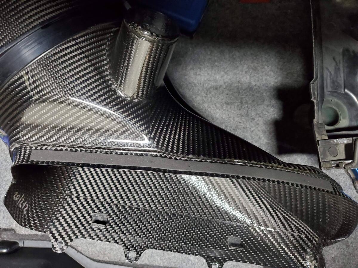

    Anyway, just to provide an update on this. The heat shrink ended up tearing after taking the unfiltered section off a few times. Decided to instead replace the foam gasket with something thicker. Reached out to Karbonius for product recommendations and they ended up sending me a roll of foam gasket for free. Super pleased with their customer service.
    What they sent me is the same thickness as what's already there, so I added a layer of it to the bottom of the unfiltered section.
    Rattle is gone once again, but time will tell if this fix is permanent. Although I will say that this feels much more solid than the heat shrink, so I'm guessing it will last longer.
