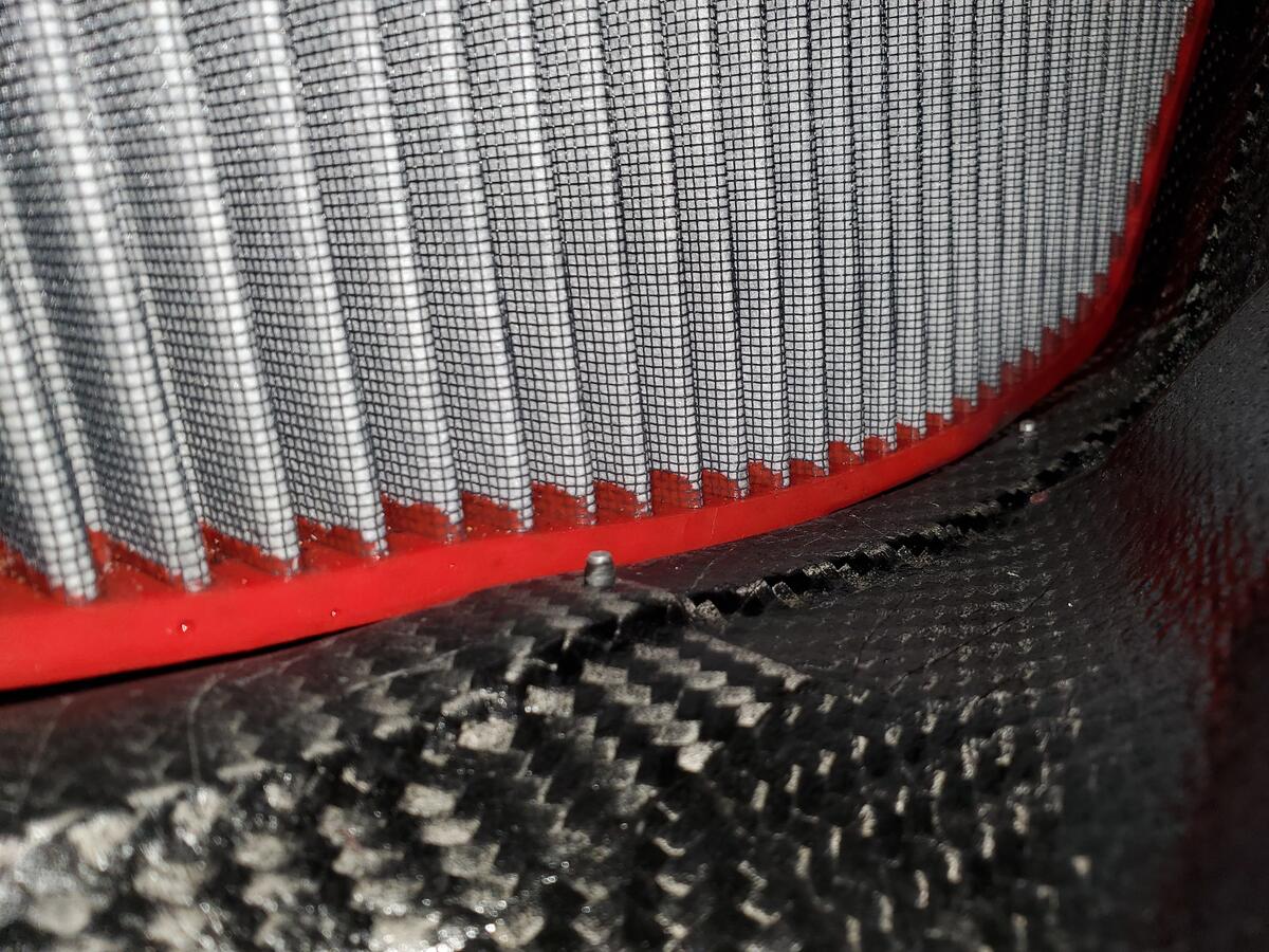

                              Decided the foam inserts probably weren't going to last so I put in some glue heat shrink.
                              Notched the posts a bit first to give the heat shrink something to grab onto:

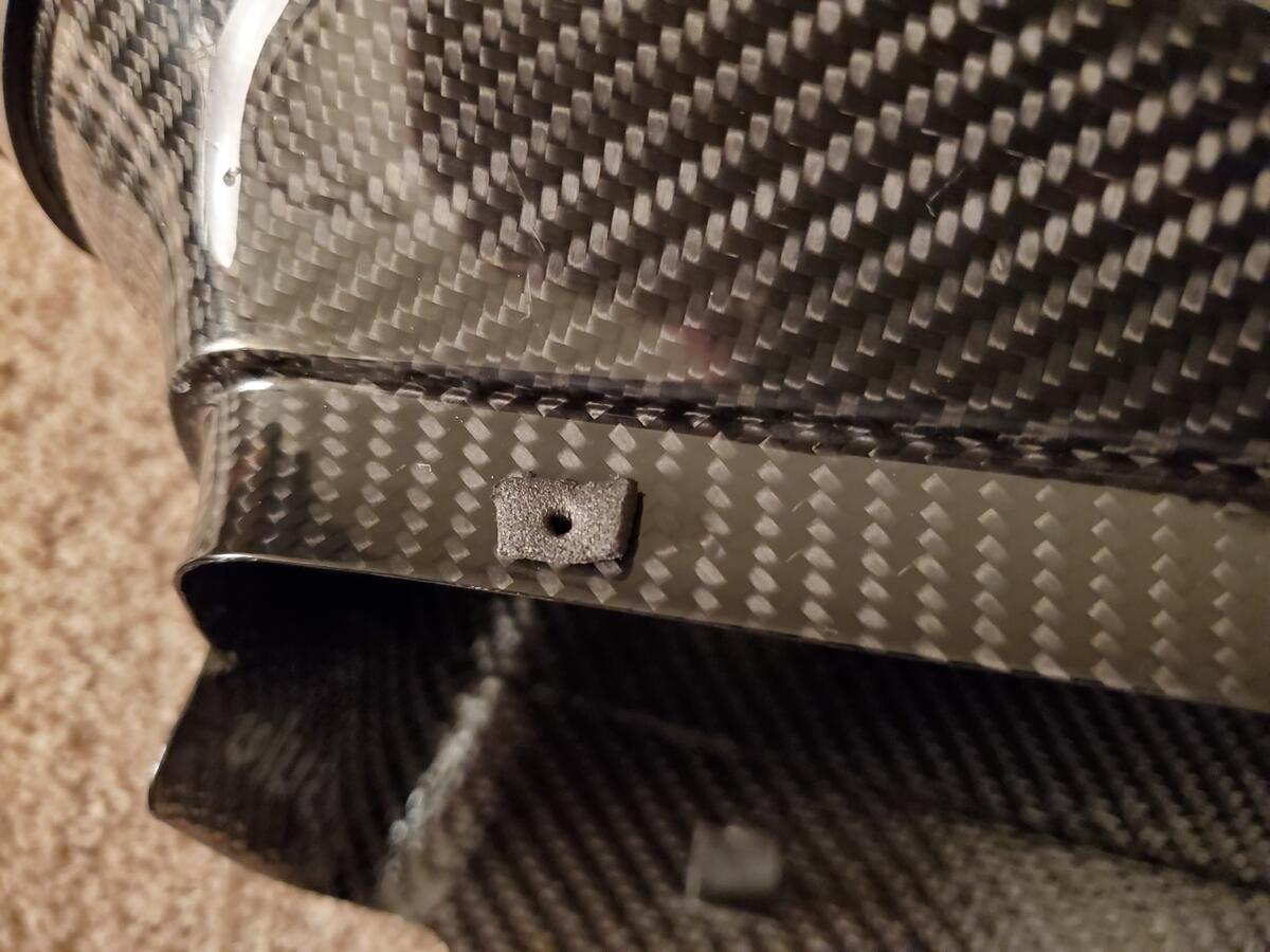

                              Then added the first layer:

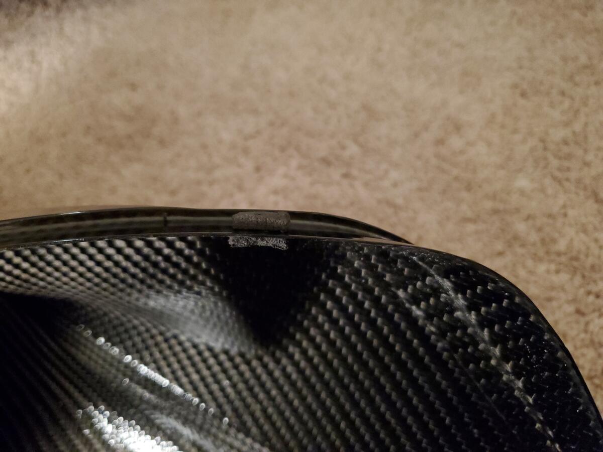

                              And then the second one. Decided to have it go past the end of the post so the unfiltered section wouldn't catch on the edge of the heat shrink.

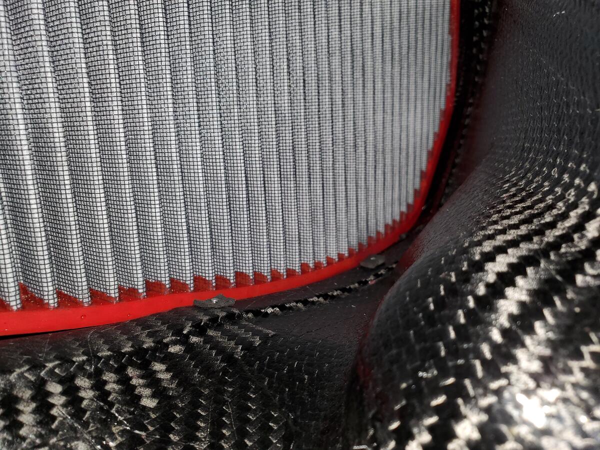

                              Doubt this will come off anytime soon. Here's a picture with the unfiltered section on:
                              No more rattle!
