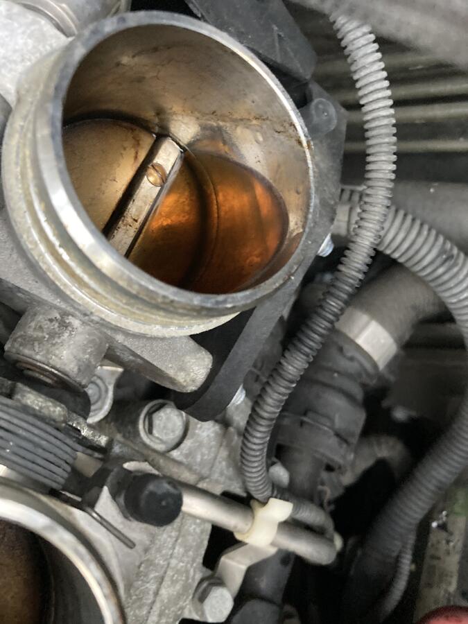

    I'll try to be as thorough as possible and start from the beginning. The first issue arose when I was driving around town and suddenly the exhaust note changed, then it felt like the car was running on 5 cylinders and the CEL came up immediately. I pulled the car to the side of the road. I tried restarting the car, and the starter would crank pretty strong, but the engine wouldn't turn over. Pulling codes found P0301 (Cylinder 1 misfire). I left the car alone overnight, and returned the next day to install a new coil pack. With the new coil pack installed, the car did start up, but still sounded extremely lumpy, and I noticed fuel shooting out of my exhaust cutout onto the ground. Still misfiring on cylinder 1. I replaced the spark plug next, and the car started but was still misfiring and shooting fuel out of the exhaust. I tried clearing the codes and then starting the car again, except this time when I tried to crank the car, I heard a big grind, a jolt, and then nothing. After this, my starter was no longer cranking, and I figured I blew my starter. Had the car towed to my house, figuring at this point that it was a failed/stuck injector on cylinder 1.
    Fast forward 1 week to today, I removed my airbox (to replace to starter) to find my ITB's filled with fuel. I have attached photos to show this. The first photo is cylinder 1 with some liquid coming passed the butterfly valve, and the worst was cylinder 6 practically spilling out of the ITB itself. I pressed on the throttle linkage to actuate the throttle bodies to see that it was completely full of fuel behind the butterfly valves. I also found motor oil in the rubber boot that connects the cylinder 5 throttle body to the intake plenum. Not sure if this is related or how oil would even get in there.
    Also, here is some additoinal info that may help in diagnosing. I have an AFD E85 kit installed currently and was running e60 at the time. RPM's at the time of failure was around 3000, I wasn't pushing the car at all and have never had an issue with the kit since it was installed. Additionally, when I took my car to the dyno, the AFR's came back lean, leading me to believe my injectors weren't very healthy and as a result I had planned to replace them soon. I have new injectors on hand currently and ready to replace if that is what is needed. Leading up to to this failure, I was experiencing a rough idle upon startup and sudden RPM drops with light throttle applied right after startup. Within 30 seconds of startup these issues would go away and the car would perform fine.
    Cylinder 1

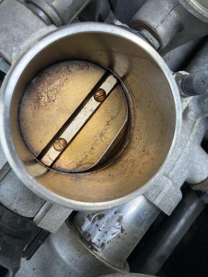

    Cylinder 6

    Is my engine hydrolocked? How do I drain the fuel out of the cylinders? What are my next steps?
    Thanks in advance for your insight.
    oh boy, yeah, I'd say that is hydrolocked. Pop the spark plugs out, suck fuel out (safely, hand pump etc), replace injectors and pray nothing got bent. Were you using stock injectors?
    edit: I see now that both cylinder 1 and 6 failed, which I find a little odd. What did you replace with the AFD kit? I wonder if the e85 ruined the injectors and they just both happened to fail. Thats a ton of fuel though to fill both cylinders to the tb's, over a liter. Did you hold the key in the forward position for like two minutes lol.

      The AFD kit replaces the soft fuel line under the car (that connects to the fuel filter) with a hard line that contains an ethanol sensor in it. It also provides a pigtail harness that goes between the injector and the oem injector loom and connects to the physical AFD controller.
      When I flipped the butterfly valves back, 1 and 6 were the most egregiously filled with liquid, but it did appear that 3 and 5 had a little bit just barely visible. When the starter first broke, yes, I held the key in the forward position for a bit once the starter blew just to see if there was any luck that it would start if I banged on the starter with a thin pole thinking maybe the solenoid was stuck...lol.
