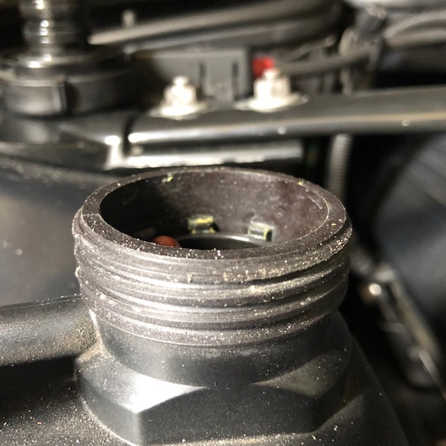

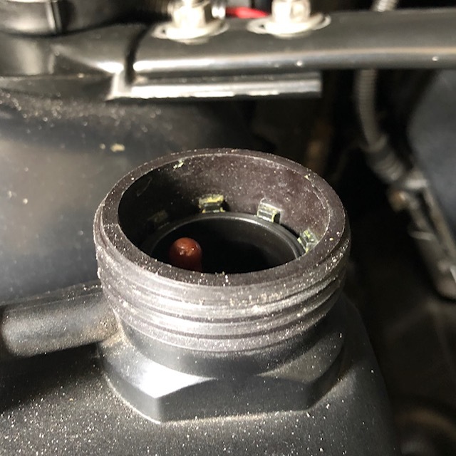

      Yeah I am thinking it might be a combination of slightly lower than max coolant, and air in the system. After looking at the coolant dipstick in the expansion tank yesterday the top circle was just under the neck of the filler. Weirdly the dipstick only has one circle at the top, it doesn't have another to signify Max and Min levels like other BMWs. I tried finding a surefire answer but I guess the top circle just has to be flush with the filler neck? I posted pics of where it was sitting after the car was fully cooled down over night.
      I'm going to do a fill and bleed today, but wont be able to really test unless I go out and drive the car hard on the street. As driving normally on the way home from track everything seemed fine.
