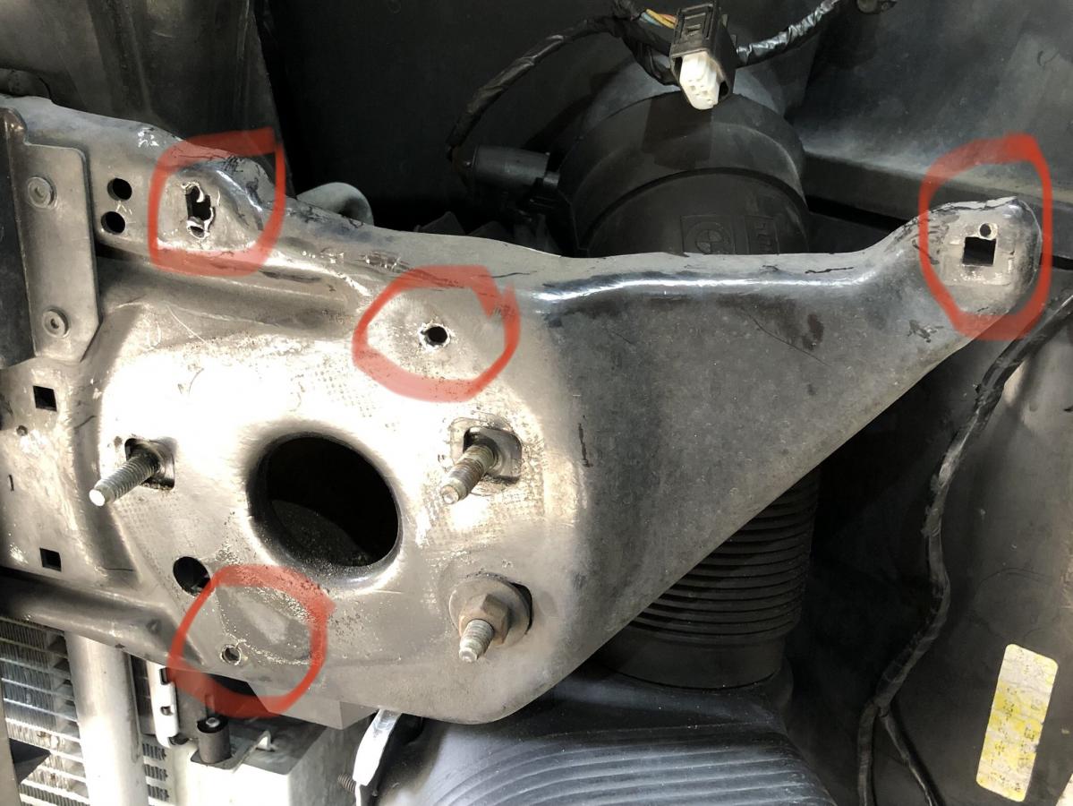

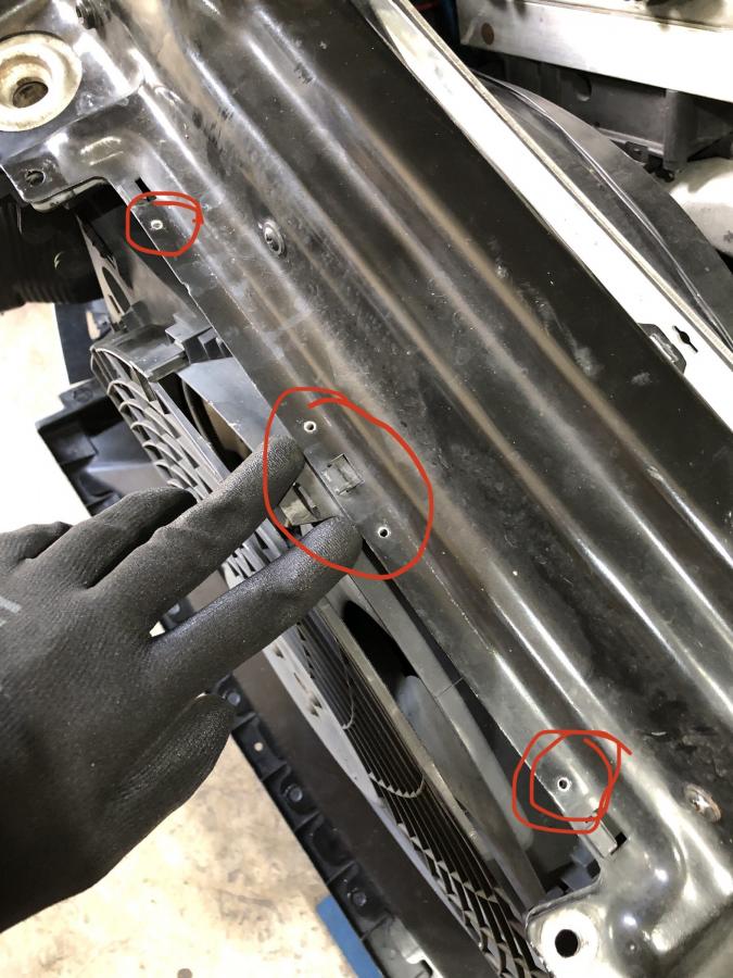

                So I finished taking apart the front end and inspecting everything this past weekend. Confirmed the recently new oe radiator does indeed have the side bracket foam gaskets installed so that's good and sealed as it should. The Top Cover plastic piece (#1) that goes over the aux fan under the radiator support was missing the rubber seals at both ends (circled in pic), so bought a new OE replacement. I also mended the broken kidney part of the Front Air Duct that sits against that missing top cover rubber seal with some plastic bonder (red arrow), hoping with a new top cover having seals and this fix itll help a tiny bit with airflow, but probably moot and insignificant if any lol.
                Click image for larger version  Name:	top cover #1a.jpg Views:	0 Size:	25.8 KB ID:	178995

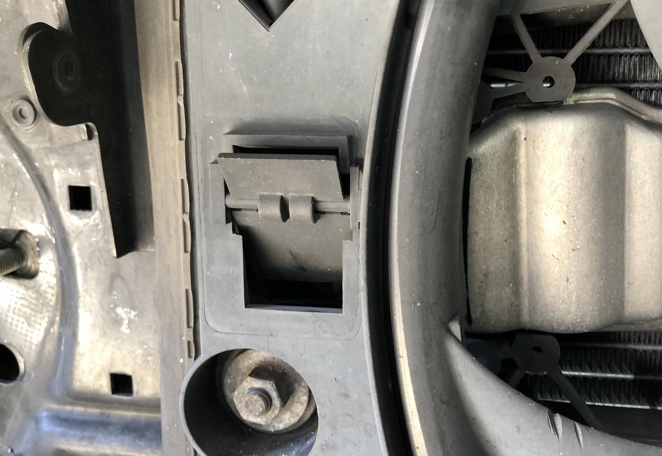

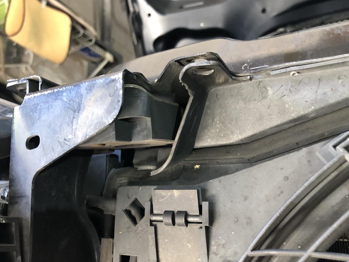

                The Aux Fan's vent flaps all looked fine and opened easily all the way, except for one. It was the one in front of the fan motor and basically blocked by it, cant open all the way due to hitting the motor so I removed the flap to help improve the flow there. Again probably insignificant in the overall and moot, especially since the fan motor is blocking the cooler surface behind it, but one can hope it'll help a little.
                Click image for larger version  Name:	AA54DE5B-805E-44D9-AEF1-1DC2E3538BFB.jpg Views:	0 Size:	124.3 KB ID:	179008
                (Flap at max open, hitting fan motor)
                Curious, has anyone removed all the fan flaps? Was wondering if just removing them all will help, not really sure what their function is for being closed at low speeds. Is it to help with initial warming up and getting the car up to operating temps quicker and more efficiently?

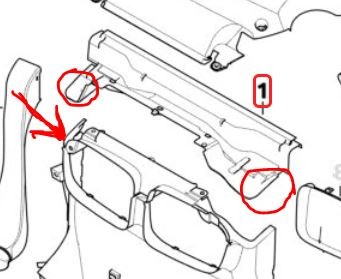

                Lastly I debated choosing to buy a brand new oe Front Air Duct (#2), or roll the dice and be a guinea pig for the BuildJournal Radiator Duct. I went with the BJ unit even though was more $ than a new oe piece but figured hey maybe it will be an upgrade and worse case maybe improve oil temp cooling even if doesn't water temps.

                    I believe the function of the flaps is to let the fan work more efficiently when stopped-- forces the air through the rad/condenser instead of where the flaps are. But, at speed, functions as if you don't have a shroud where the flaps are.
