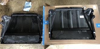

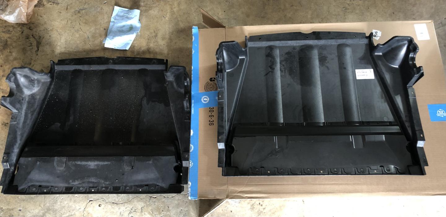

            Since then, as a further step I replaced the banged up and cracked plastic under tray belly pan with a new unit, in hopes that maybe that will help with airflow behind the radiator since I read about potential pressure differences problems w/ a cracked pan letting turbulent air flow into the engine bay. Who knows, I'm not an engineer and havent truly studied aero and thermodynamics.
            Click image for larger version  Name:	53B9FD17-F823-4B22-9E20-4236DC08C49A.jpg Views:	0 Size:	134.6 KB ID:	177715 Click image for larger version  Name:	05AA13CC-67DB-4FF9-8630-EA165A7BB9DA.jpg Views:	0 Size:	100.7 KB ID:	177714 Click image for larger version  Name:	91FD6207-336F-4B6A-BEA0-20BB12FB6C2F.jpg Views:	11 Size:	113.7 KB ID:	177732
            Old vs new belly pan
            Well I didnt really get to try this out to see any improvement as my next track stint was a maiden voyage to the world famous Sebring International Raceway, where I only got 2 sessions in before day was cut short due to lightning. I didnt really get to push the car hard since was my first time on that track, but again I saw water temps go past 200F and approach 210+ when pushing

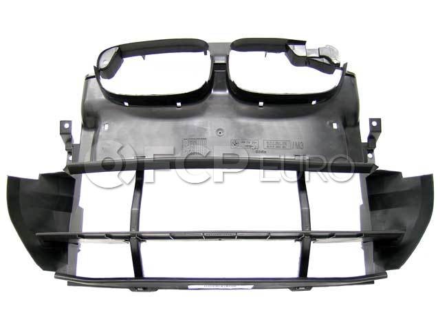

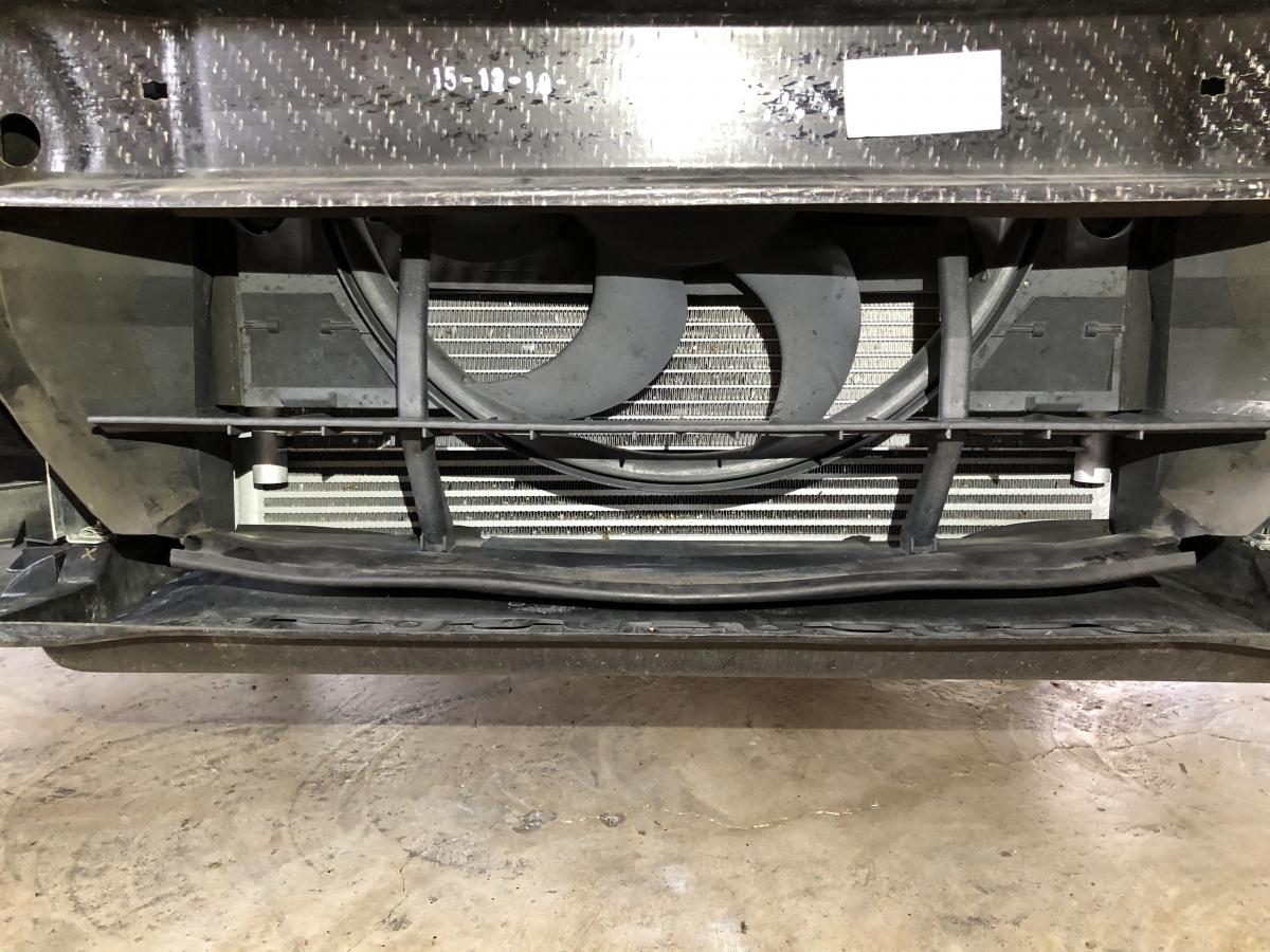

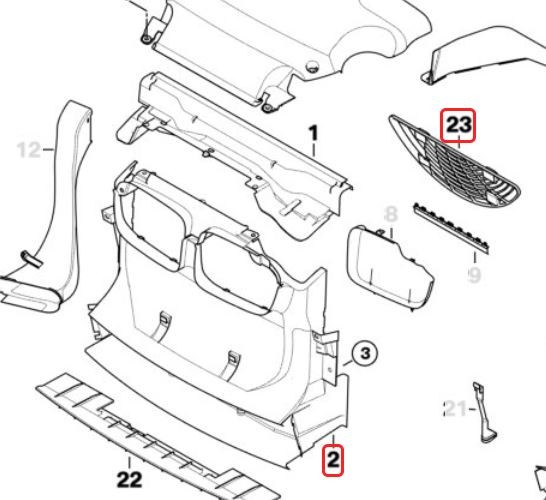

              First check, the front air duct. Yeah the bottom part of the plastic is dipping down a little bit but looks like the CSF oil cooler is still lower than the flaps, maybe it dips down at higher speeds who knows? And there is one piece by the upper rightside kidney part thats' sheared but again doubtful this is a major issue.
              Click image for larger version  Name:	realoem front end ducts.jpg Views:	0 Size:	51.5 KB ID:	177721 Click image for larger version  Name:	open-uri20170126-7343-6k29vi front air duct.jpg Views:	0 Size:	36.5 KB ID:	177722
              How a fresh new Front Air Duct looks above

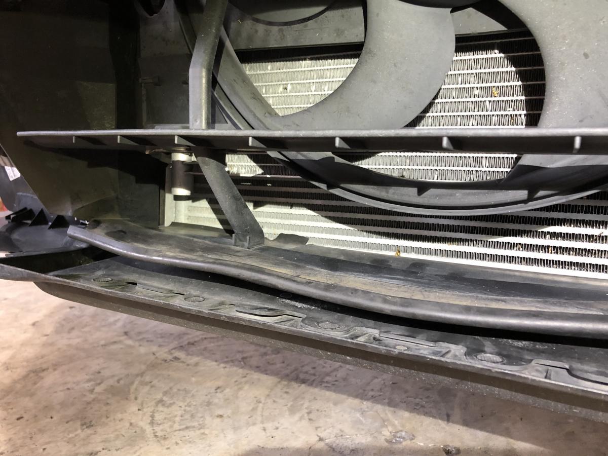

              Click image for larger version  Name:	8E9513B3-D47C-46E8-91C4-01A6CEAECA0A.jpg Views:	0 Size:	166.5 KB ID:	177730 Click image for larger version  Name:	2D1133DA-D357-4F0D-87DF-74925DFA0E97.jpg Views:	0 Size:	150.3 KB ID:	177729
              How my Front Air Duct currently sits, note the droop of the bottom, bowing down a bit. Significant to contribute to the overall cooling dilemma?

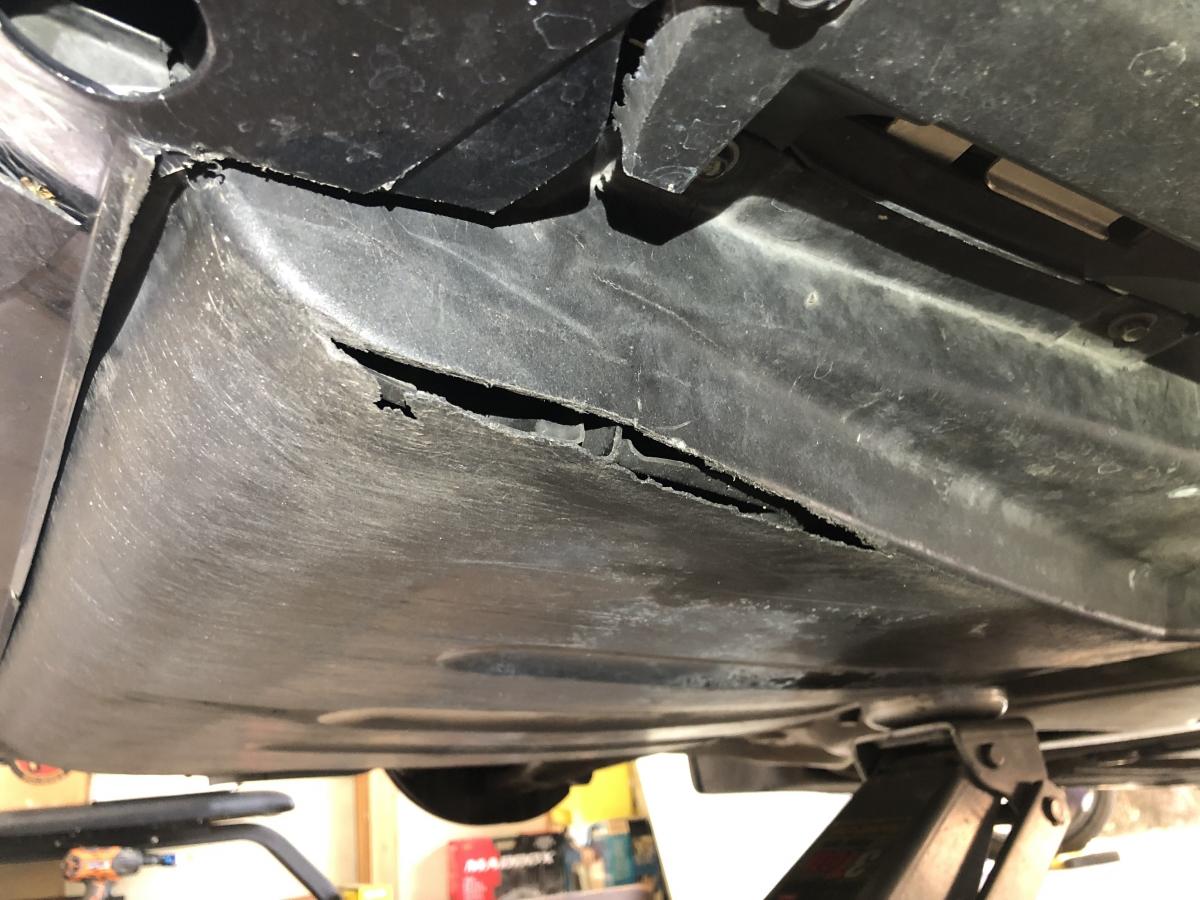

              Click image for larger version  Name:	A648F3E5-FEF7-4FE4-AFDC-E971B69452C9.jpg Views:	0 Size:	122.6 KB ID:	177960
              The shear at the upper right side kidney area, insignificant most likely

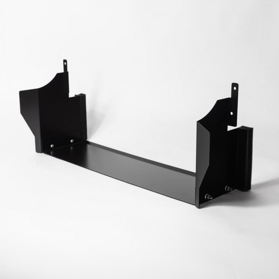

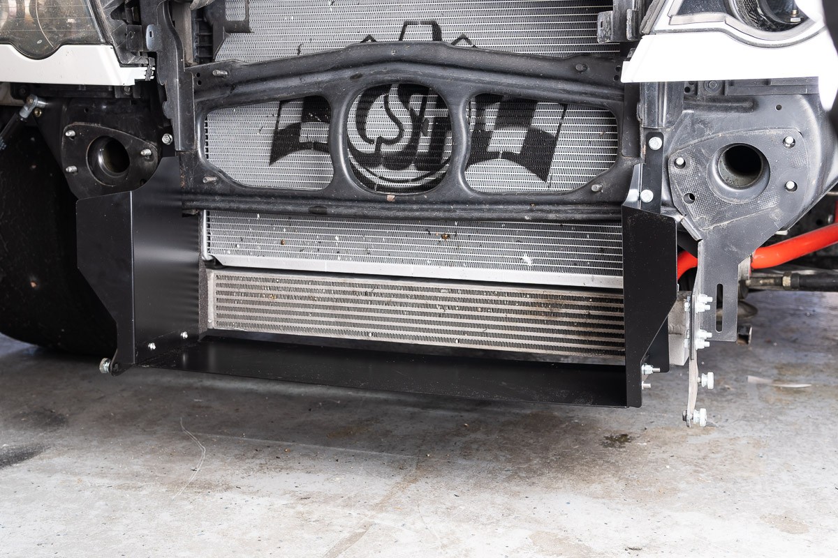

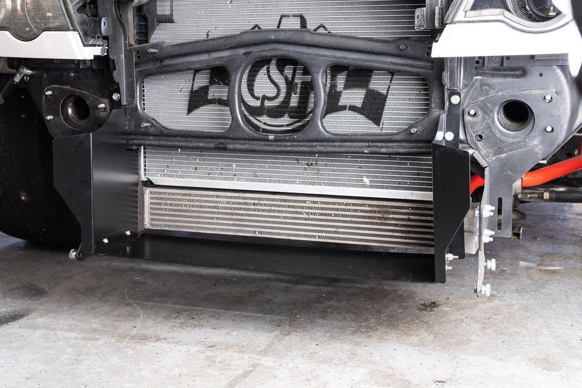

              I began to consider the Buildjournal Radiator Duct as a replacement/upgrade, does anyone have experience with this piece? Seems to price out to the same as buying a new factory front air duct + lower grill (my car was missing that too of course, #23). I figure it doesn't hurt to try it but seems it'll more beneficial to oil cooling than water, and again my oil temps are under control (never touched 250F surprisingly even with the water temps soaring).
              Click image for larger version  Name:	e46_m3_radiator_duct_buildjournal-3.jpg Views:	0 Size:	25.8 KB ID:	177723 Click image for larger version  Name:	buildjournal-e46-m3-radiactor-duct-19.jpg Views:	0 Size:	304.7 KB ID:	177820
              https://thebuildjournal.com/shop/bmw...r-duct-e46-m3/

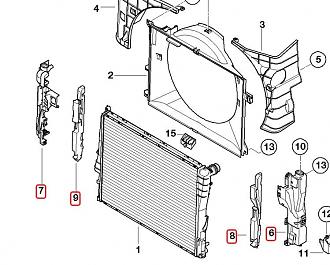

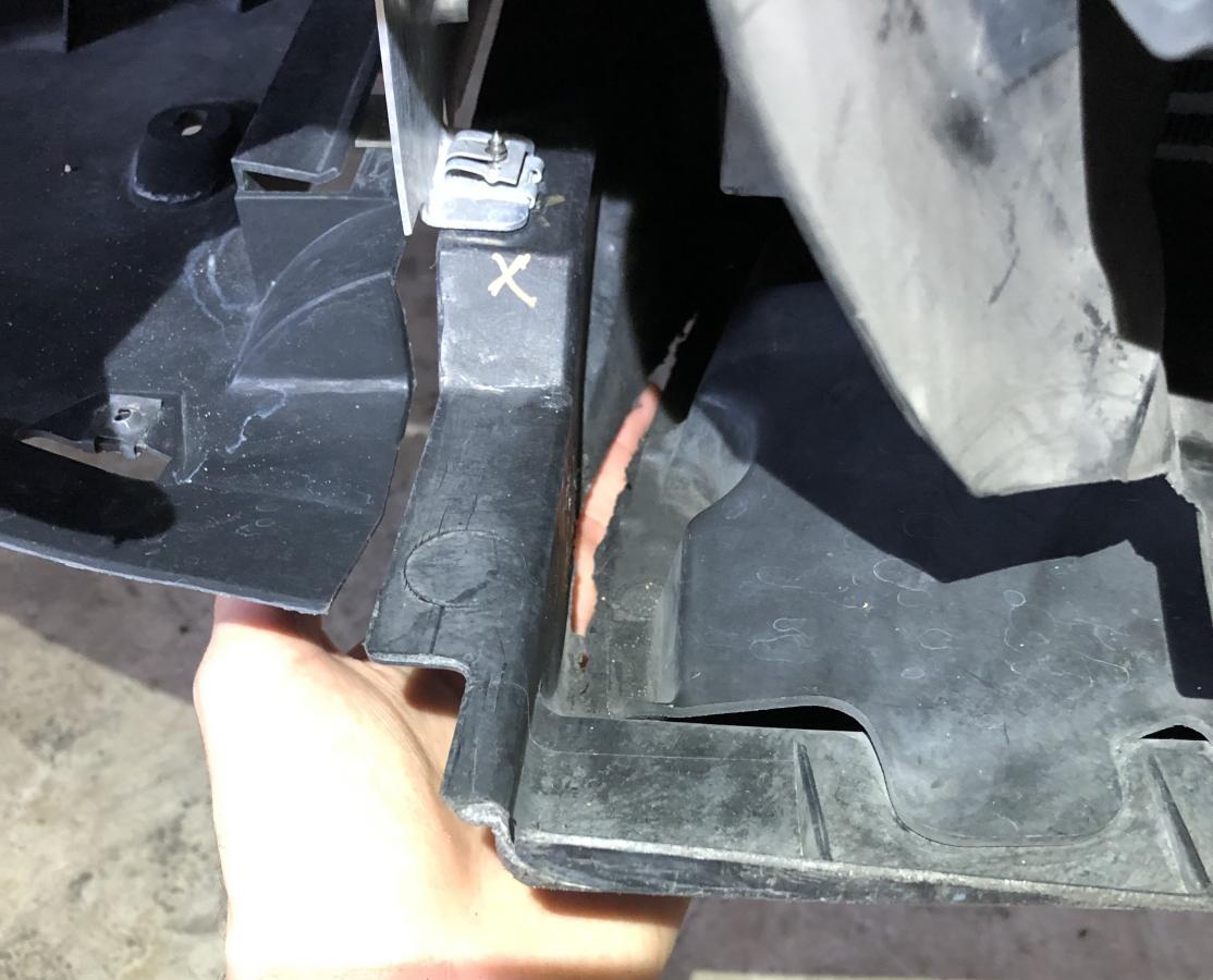

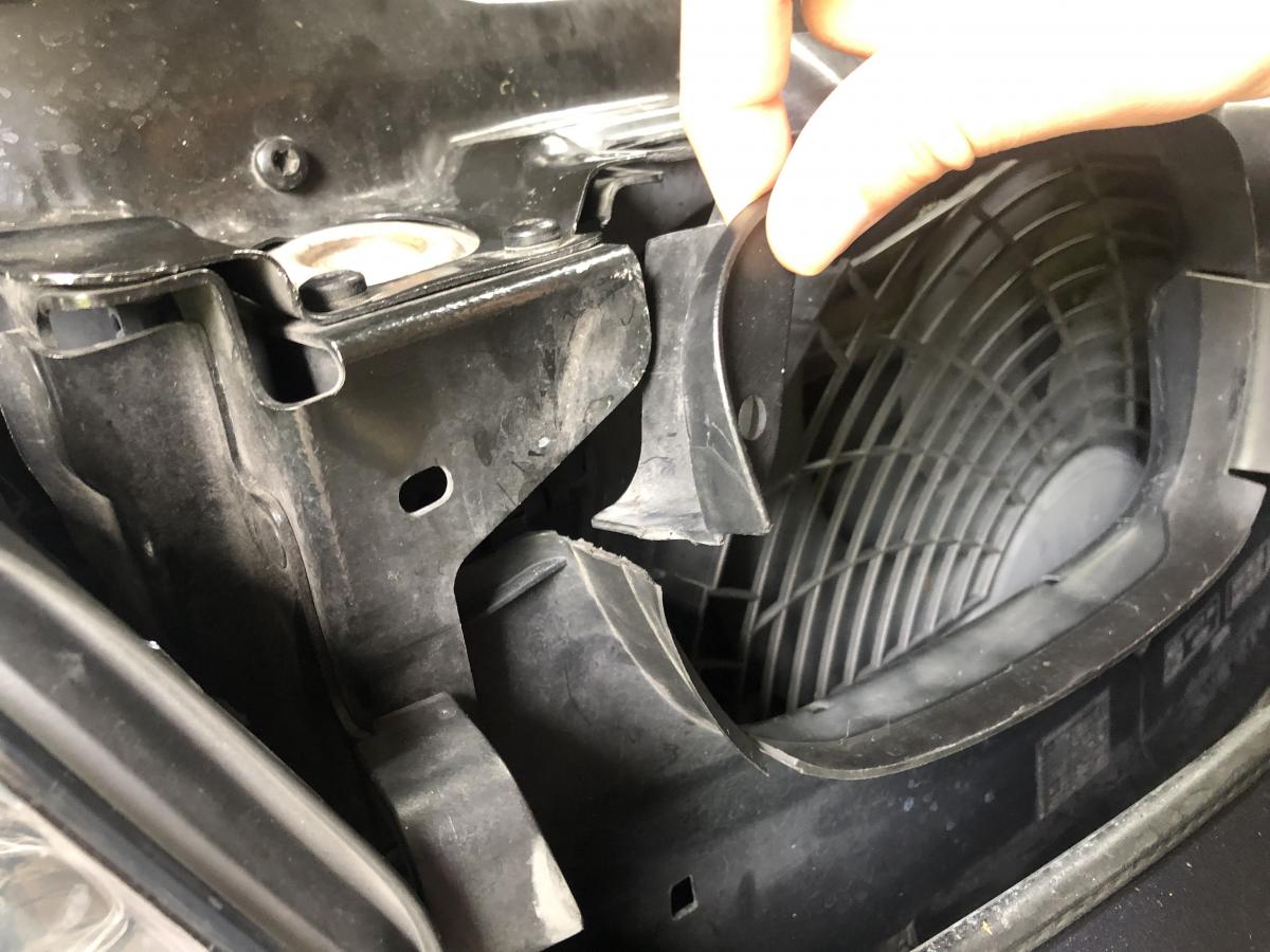

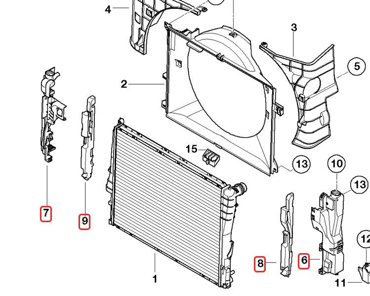

              Next was to check around the radiator itself, looking on realoem i see the side brackets and gaskets highlighted below. I am planning to take off the whole front end this weekend to really get in there, but right now I can shine a light through the sides of the radiator between each headlight housing (pictured below)... is that normal factory setup or am I truly missing these bracket/gaskets or something? Can anyone else confirm how the areas on the side of the radiator look on their own car from factory? I'm sure #6 and #7 are there as they seem to be brackets that hold up the radiator, but i cant visually confirm if those gaskets #8 and #9 are there, at least not without yet taking things apart.
              Click image for larger version  Name:	image_36881.jpg Views:	69 Size:	113.7 KB ID:	177724
              Click image for larger version  Name:	image_36886.jpg Views:	65 Size:	92.3 KB ID:	177733

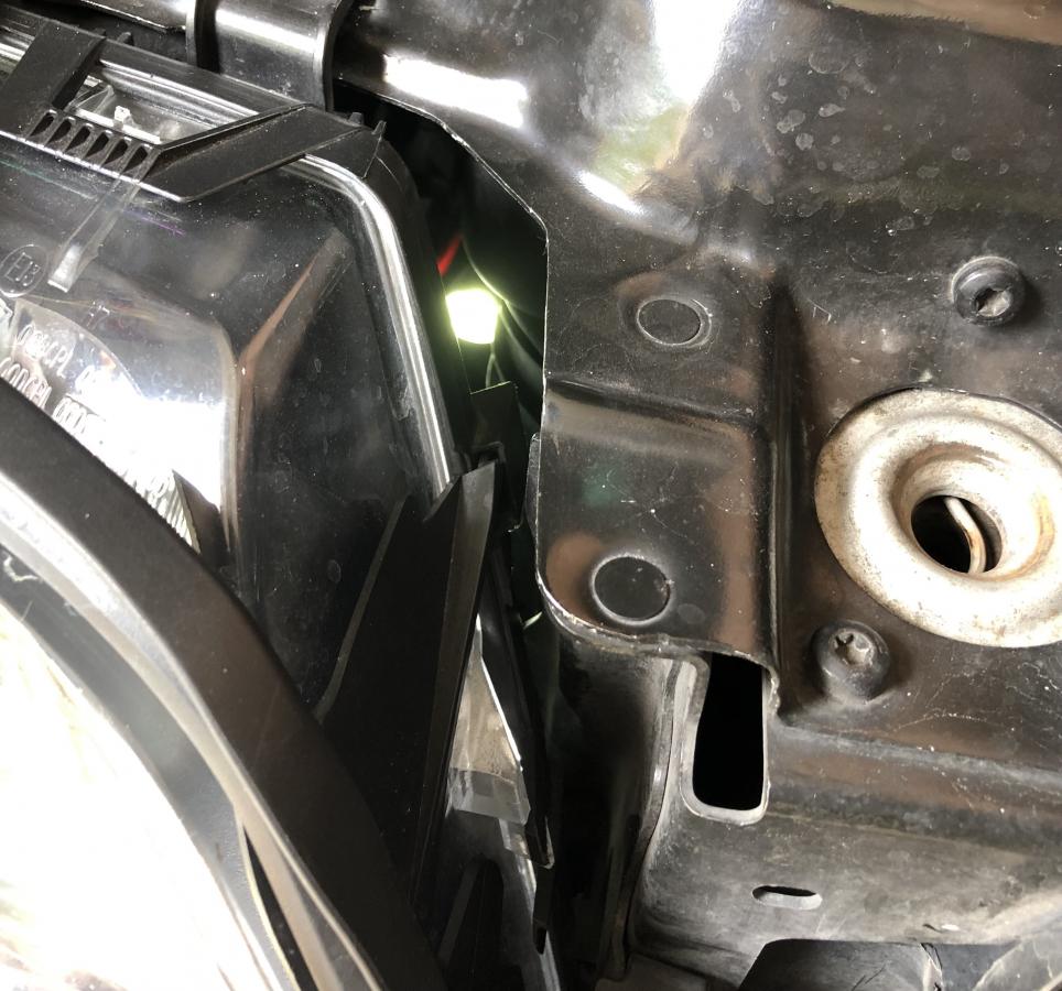

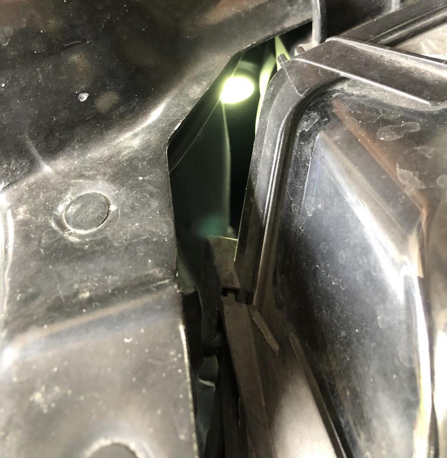

              Drivers side radiator 'gap' with lamp shining behind
              Click image for larger version  Name:	image_36887.jpg Views:	65 Size:	112.2 KB ID:	177734
              Passenger side radiator 'gap' with lamp shining behind (normal or missing pieces due to front end accident from past?)
