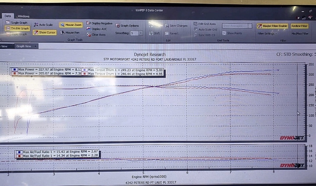

Obioban You and the others could be onto something about the TTFS tune... but since I got the car tuned, I've done 2 track days (Homestead and PBIR), 1 drag strip night with 4 passes, and 1 autox with it before these last two track days that I had high water temp. I cant say for certain if my water temps were dead center during those previous events, but def not like what happened in late November that made me make this thread. Unfortunately I dont have a stock tune to flash back to, my car came with the ancient AA tune from the previous owner, and the tune I had before the custom TTFS was Buildjournal's B-Spec...

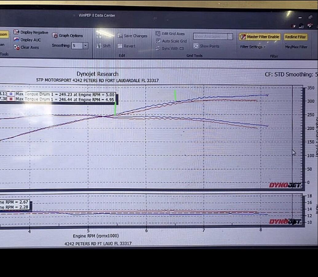

I also posted the dyno graph, to show the AFRs, its a photo of the monitor so kinda grainy.

The other thing is on the tune, a lean condition makes the car run hotter. Check around for leaks past whatever air metering you have, or if the tune disabled knock sensors so it could run leaner that would be a problem too. I would suspect something other than the radiator with it being limited to higher RPMs. Could be fueling too if it's a lean condition causing the problem.

The one on track engine failure TTFS (custom dyne) tune I have seen had the knock values turned way down, despite the owner requesting a safety over power tune-- and detonation was what led to his engine failure.Originally posted by tnord View PostIs this a track car only? If so, you can gut the thermostat. Most of us did that on our SCCA cars, or just take it out entirely. I haven't looked at how the M3 thermostat is integrated so it may not be possible.
The other thing is on the tune, a lean condition makes the car run hotter. Check around for leaks past whatever air metering you have, or if the tune disabled knock sensors so it could run leaner that would be a problem too. I would suspect something other than the radiator.

I've also seen a TTFS tune with the knock threshold turned way up (i.e. engine allows more knock to happen). It was like 35% higher than stock.Originally posted by Obioban View Post
