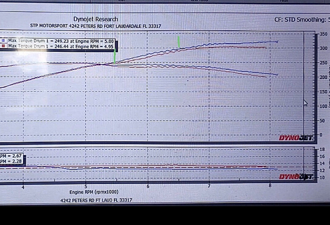

              Thanks for this insight! Yeah havent been able to look into the car since my last post, and dont have any track days planned or coming up. Have barely even driven the car in 2 weeks other than to run some errands. But yes hoping I find some small leak I wasnt seeing before and it ends up being that it was the small pressure loses causing the overheating. Thats my first step is have the cooling system fully inspected by my indy since I cant seem to find anything wrong myself.
              And for the guys going off topic on the t-stat operation; my car is a full on street car with a/c, full interior, sound system, etc. Regardless how the t-stat operates I'm not modifying it... I shouldn't have to. My cars just a stock n/a S54 with bolt-ons and tune lmao.
              Btw i did post the dyno graph with AFRs.... I dont see any one commenting on that? I figured someone would mention it looks a little lean on top compared to the B-spec baseline tune?
              Also could a failing fuel pump cause a lean condition, in turn causing the engine to run hot? So many damn variables...
