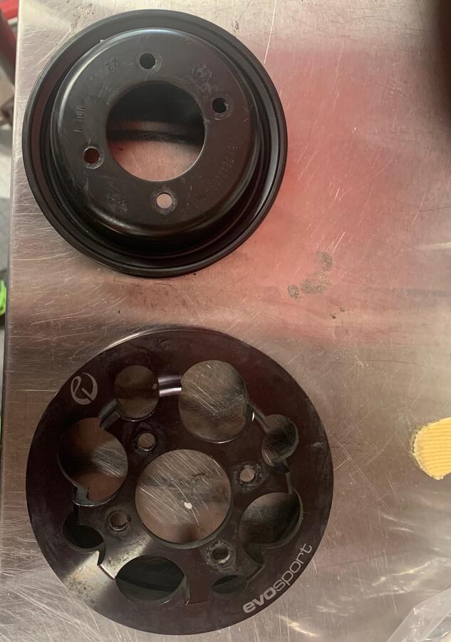

                  What do you guys think? the Evosport pully is almost 1'' larger, that would make the WP spin slower, most noticeable at high RPM which I think this is why it's only overheating at the track.
                    It’s certainly not improving your cooling 😜

                      Well, disappointing results nonetheless. Replaced both pulleys with no improvement, although it's only when pushed hard, with several pulls back to back to 8k RPM, the temp will go over 205 degree and move the needle pass the half point.
                      I'm running out of ideas, next I'll have to check the tune. Planning to take it to the dyno to get air/fuel ratio and see if that could be culprit, although I don't have high hopes. Any ideas/suggestions?
