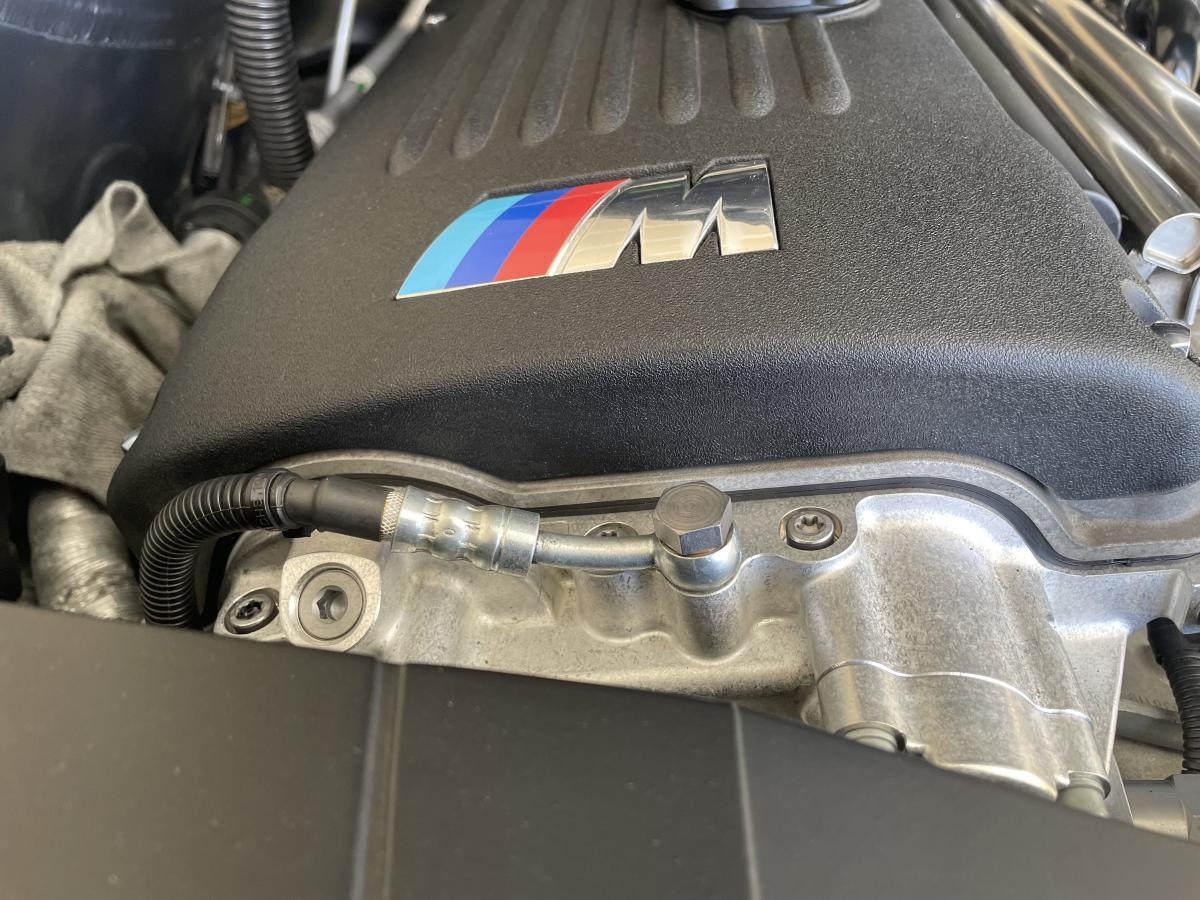

ID:	280059 Here is the ECS line, as said, I liked it can run parallel to the cam cover
Name:
      This motivated me to go with ECS since my factory one was leaking. Looks very neat. Thanks for those pics!

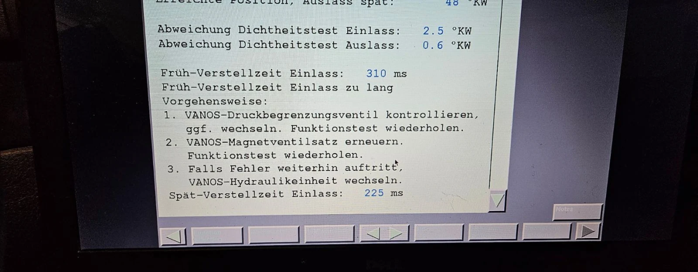

                  Last Thursday, I drove the car to my office and noticed something felt off. In the 5 AM rush hour traffic, I couldn’t push the car much, but I felt a slight hesitation. On the way home, still in heavy traffic, the CSL intake sounded deeper than usual. About halfway home, the check engine light came on. I initially suspected an issue with the IAT or MAP sensor wires, but after pulling over, I confirmed they were fine.
                  Once home, I connected the GT1 diagnostic tool and pulled code 184: "Function, inlet VANOS." The Vanos test was failing. My car has been sluggish on the advance time, and the inlet Vanos test has occasionally failed completely.
                  Example:from a few months ago
                  On Saturday morning, I removed the Vanos actuator and used a Dremel to open the back for inspection. Three of the six solder joints appeared cracked, so I resoldered them and epoxied the cover back on. While the solenoid valve was off, I decided to sonic clean it, both with the solenoids open and closed.
                  This is just a theory, but I suspect the cleaning freed up the valves significantly. After reinstalling the Vanos actuator, the first time I pushed the car, the hose failed. It’s possible the 12-year-old line was accustomed to reduced pressure and couldn’t handle the restored full function, causing it to give out.
                  Once I get the hose replaced I plan to run the Vanos test again and see if things have improved.
